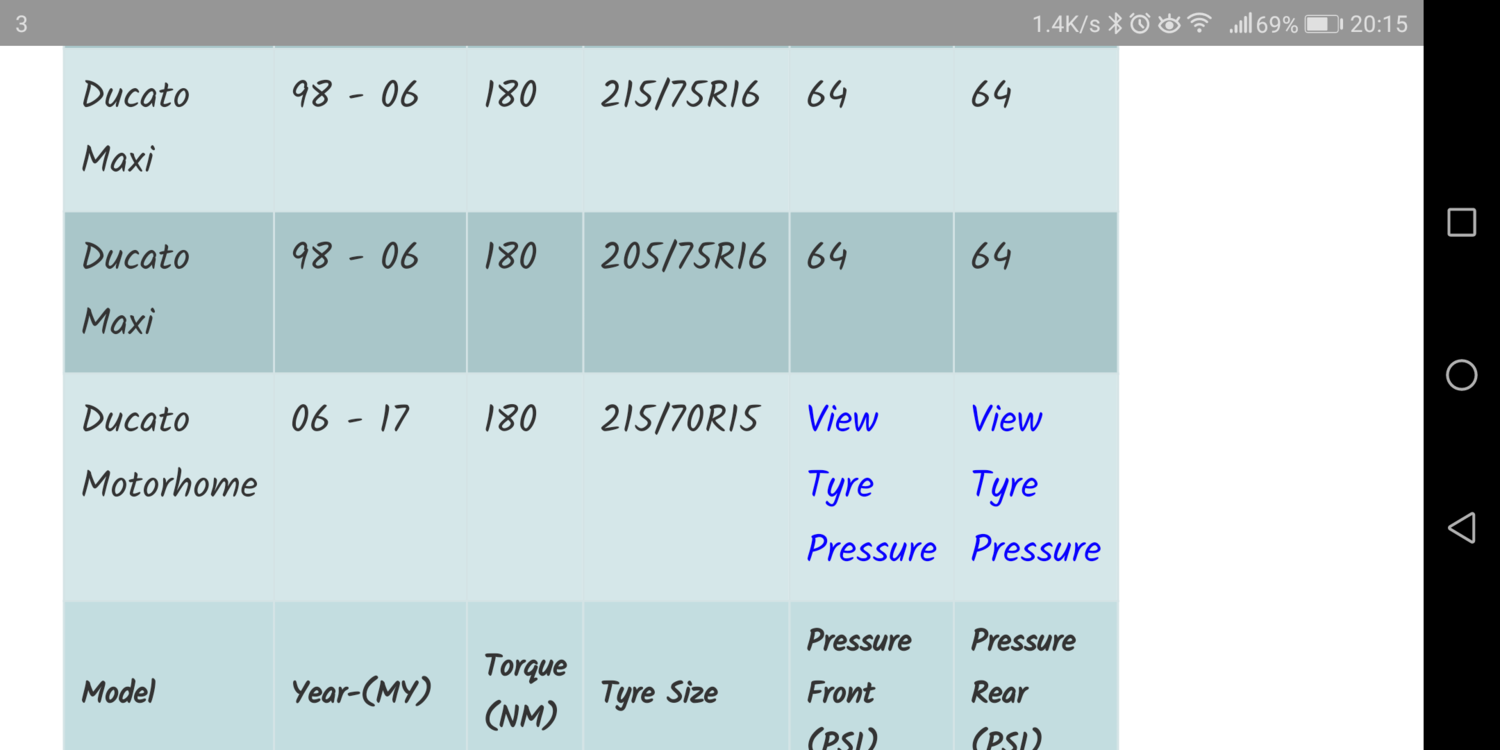

10 seconds to Google. ...
180 Newton meters.
133 ftlb
