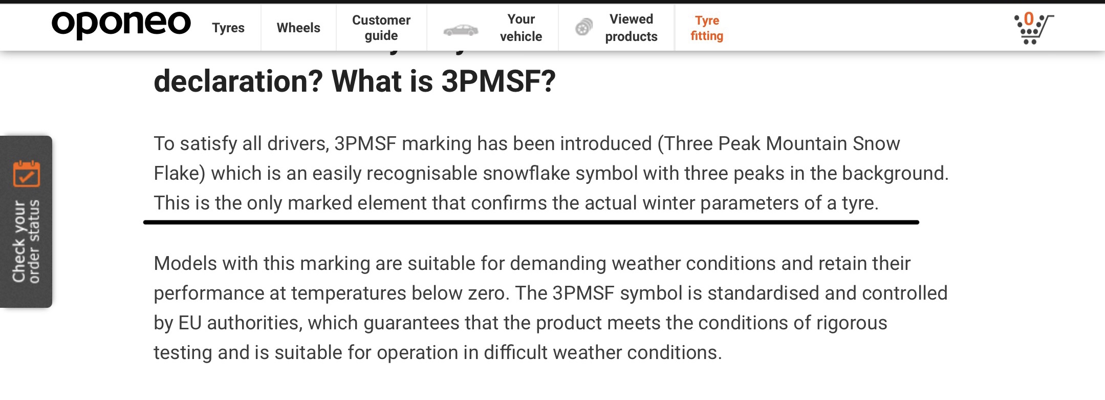

Thought the "3peaks" markings... NOT M&S... Designated winter approved tyres.
Cross Climate's are an All Season Tyre and they are marked with both M&S and 3peaks. Therefore IMV designated Winter Tyres.

And just to reiterate the winter tyre requirements abroad, here's an update on the French legal requirements.
Cheers,
Jock. :)
SheikhLala you need to ask yourself if you are planning to go to Europe in the winter as there are specific requirements around the need for three peak marked tyres. Some funsters run winter tyres all year or you can look for a compliant all season tyre, such as the Maxxis vansmart AS/AL2 all seasons three peak marked tyre (this is a van tyre not a camper tyre) as highlighted by rb62. I also use these and have been very happy with them. There are of course other all season tyres as well!
