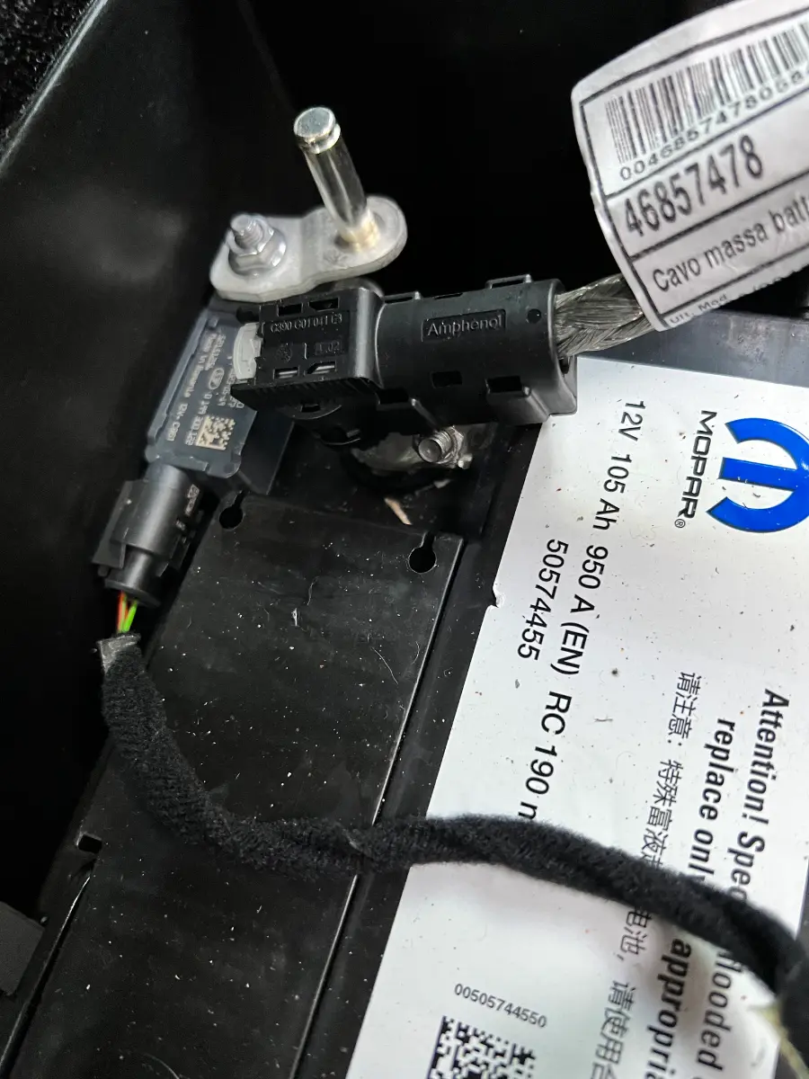

I have attached a photo of the battery, any idea what these numbers / codes mean? Don’t want to spend the money on a new battery for it not to be the right one.
Standard wet (flooded) lead acid battery.
95Ah - 95 Ampere-hours - typical camper van starter battery capacity
900A - 900 cold cranking amps - the current available to turn the engine over in cold weather.
Yup. . 019 on my Relay.
Think 020s are an option as well but best double check.
Looks to be a like for like specs wise. If you're anywhere near Bradford as it's collection only. Date looks to be 11/09/2022.

Measure your existing battery in mm to ensure it will fit in the space; height, width, length. Also it looks like it is a stop/start battery.
With those dims and the battery performance already mentioned above (105 ah capacity and 950 cca) you can find a match.

After measuring up the battery and putting the dimensions into this tool. I’ve found out it’s actually a 020 battery and all the 020’s line up exactly with the spec on the current battery.
