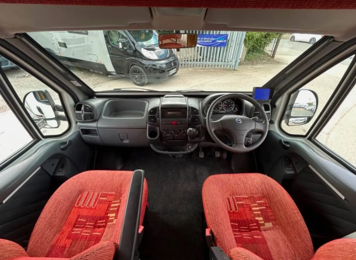

Here’s the dash
Fiat Ducato 15 MWB 2.3 JTD may be what they are looking for as a base ?
From the pic of the dash and the fact it is a 5 speed not likely but will be an X244 as previously mentioned.
It's definately an x244 but I thought the 2.3 multijet engine came with the x250 ?
I thought the x244's were either 2.0 JTD or 2.8 JTD
Happy to be corrected
2006 was the crossover year from X244 to X250, perhaps this van was built on an older in stock chassis
