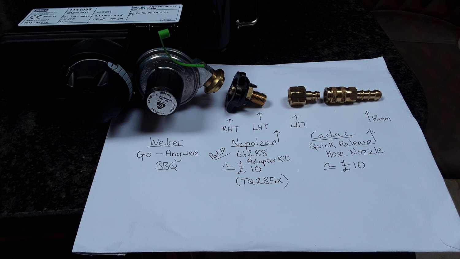

I recently bought a Weber Gas Go-Anywhere BBQ that comes with its own built-in regulator. It only accepts gas screw on canisters and I want to be able to use a Camping gas 907 canister or indeed any gas bottle - especially when I am in Spain. Weber do do an adaptor kit but it is designed to be coupled to a Calor patio gas bottle and it is not quick release and has to be screwed on to the Weber BBQ every time you set it up. (plus it costs approx £40)
After much research and with little help from any BBQ specialist outlets ("this BBQ can only be used in the UK") I has found a Napoleon Adaptor kit (TQ285X 66288 approx £10) that screws onto the thread for the gas canisters on the Weber and a Cadac Quick Release Hose Nozzle approx £10) then screws onto the Left Hand Thread on the back of the Napolean Adaptor. The other end of the quick release has a standard 8mm tail that will push into a standard rubber gas pipe. If this does not make sense please see the photo attached.
318728
I can now use the quick release to easily attach the gas to the Weber BBQ and I can attach the other end of the rubber pipe to what ever gas bottle I wish to use.
I hope this will help someone who is struggling just as I was.
Absolutely fine doing it that way, so long as you ensure the screw on adaptor is fitted tightly
I converted our cadac to quick release, with the other end of the hose having another quick release and a choice of made up ends. a bullfinch adaptor for the side of the van and a bottletop regulator so I can run it of a cylinder in the garden

Something that I learned when sorting out this problem was how to tell if a nut was a left hand thread. Left hand threads should have a grove cut around the middle of the "nut" where the spanner goes. This can be seen in the photo attached to the original post on the middle part. I can also confirm what Orion stated above - one regulator feeding a second regulator is a no go! I can recommend Hamilton Gas Products Ltd as they have a great range of products. Unfortunately, I did not find a single shop/supplier that would give advice as it is gas that is being used and safety is involved.

That looks externally like the bit I used.
