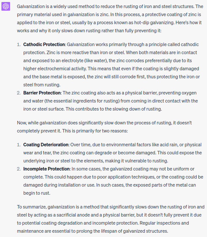

I was just starting to write a quick explainer of galvanisation for those who don't understand what it means and remembered my chatGPT subscription. Here is what it had to say. I completely agree with it.
Fiat's are galvanized and painted, all coated steel wether or not it's galvanized, painted or other special coatings is just a way of extending the the life of steel. Galvanizing if by far better than most as the whole structure is dipped in a hot vat of zinc so gets in all the places other coatings can't reach but still not 100%.
The thing with galvanising or painting is that it creates a barrier, but anything that breaks through the barrier, scratches or drilling will leave raw steel exposed. Especially with drilling or cutting, the localised heat produced will cause very quick oxidising of the area which then spreads under coating. A very important reason never to drill into or cut a galvanised chassis like the ALKO ones. You often see the begginings of rusting soon after accessories like towbars etc get bolted on. A quick application of rust converter, allow it to dry and coat with lanolin based rust inhibitor will prolong the life of the van
Likewise, if your vehicle gets damaged and the metal bodywork repaired, it lets rust start from the inside of the panel. Coating the inside with lanolin based inhibitor will extend the life of the vehicle

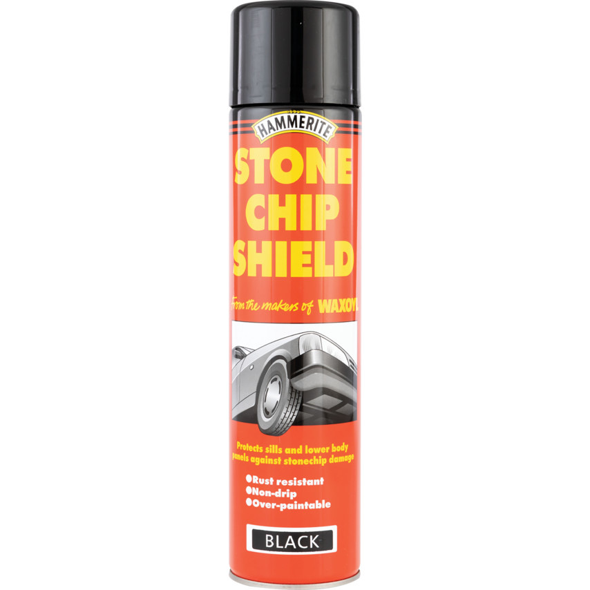

I’ve used this extensively across all my vehicles, including the van. Easy to apply as well with a very good spray discharge.
Removed all inner wings on the car and front ones on the van and everywhere’s had a good under-sealing 👍🏻
I personally avoid stuff like that. It rusts from behind and you can't tell until it is too late. I really hate the stuff now.
check this video out :( My van rusted from behind after using this. I ended up writing the van off.
I have seen a car where pretty much the whole floor pan dropped off in one piece just after passing an MOT. It was covered in underseal, which hid the extensive rust under the carpets. Black waxoyl is very similar and is a magnet for dirt sticking to it. Working on it afterwards is a messy job and welding becomes a big gamble
