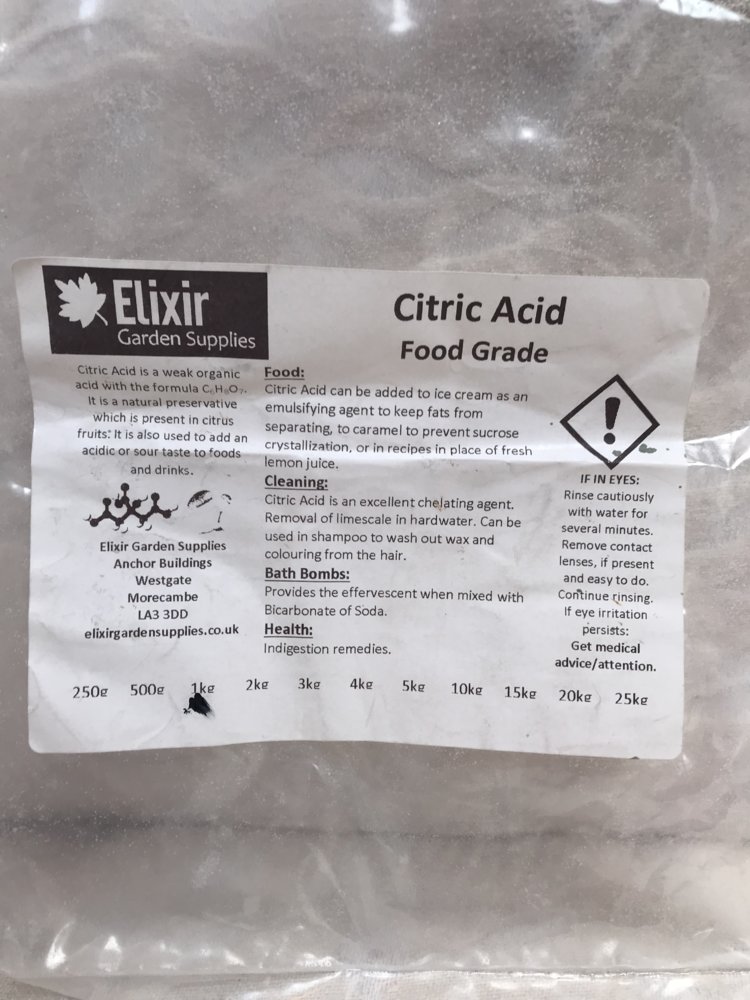

Just been through the descaling process.
Added this 1kg bag (from fleabay) to the fresh tank (diluted first in warm water) and filled to full. Ran through all pipes and taps, running both hot and cold to ensure the heaters filled.
I left mine for 2 days as I couldn’t get to rinse until then.
Nice clean and sparkly water and both fresh and grey gauges working again.

I am definitely going to try this, I could leave overnight and then drive down to the water and waste area and flush through a couple of times(y)
Ps what is a bath bomb :eek: ( on instruction leaflet) ?!!!
Those fizzy thing-a-ma-jigs that you can buy (usually in a compressed ball shape) and throw in the bathtub when the taps running. They then fizz and dissolve leaving the bath full of citric acid to remove any scale you may have accumulated in those oftern hard to reach places :)
They also soften the water too:)
