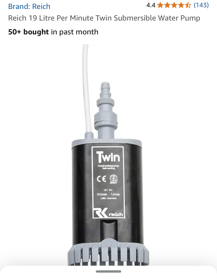

Hi.
It’s this pump.
It’s the same as the old one.

You need to bleed through all the taps hot and cold ...one at a time is fine...however that looks like a low pressure pump of the type that are controlled by micro switches in each tap,..not one I'm familiar with ..when you turn a tap on /off does the pump start/stop instantly when it's working normally or does it run for A few seconds after the tap is off?

That is a submersible pump and is operated by a switch on each tap.
If the pump is running then you either have a tap/shower in the on position or, a wiring /switch fault which is shorting so continuously calling for water. This may have been the cause of death to your last tap.
