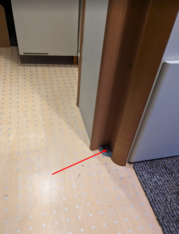

I have just bought a 2008 Auto-Sleeper Warwick Duo. It had a full habcheck, however we used it the first time this weekend and we have a serious water leak. It's not from rain it's from the internal water connections. It seems to be behind the toilet. In the first picture I have shown on the floor where the water is coming out from - basically underneath the bathroom back wall. I'm thinking a joint is leaking as it only leaks when the pump is on. I have no idea how to get to inspect any of these parts. On the wall behind the sliding door there are screws (blue arrows) that can be removed and I could remove the toilet access frame. Would I be able to remove that panel to get to the water pipes?

Start off by removing the toilet cassette and see what you can see.
When mine is removed I can replumb many parts on my van.

I have drained it all now. I think I know how to get access to the pipes. I will try later today hopefully.
I can't get any of the panels off - very frustrating. Hopefully Auto-Sleeper will respond to me.
However.......I noticed when I opened the outside shower flap that the shower head and generally around it was very wet - maybe this is the cause as it's in the right area where the leak is originating. The tap seems like an odd one. It turns left and right for hot and cold and also up and down - not sure if the up and down is to turn it on and off - because the head has a trigger. Anyway, maybe when I was looking at it when we bought the van we didn't close the tap properly. Tomorrow I'll fill her up with water again and see how the outside shower works.

Another thought, we had a seepage of water from under washroom wall once. It turned out to be from a blocked drain behind the tip up washroom sink. Do you have one of those that tips up and can be lifted out in the 45° position? If so check the drain behind it.

Yes, ours is like that too - I'll check.

Only leaks when the pump is running.
Had a problem with a similar wet floor; where the drop down sink tap was stiff in turning the spout it had rotated the push on connectors on the pipe, which fell off! Had to be shown the access hatch behind the toilet under the sink, blimey, you need a 2 foot long piece of string as a forearm to get up in there! Aaaargh I hate that bloody thing!
