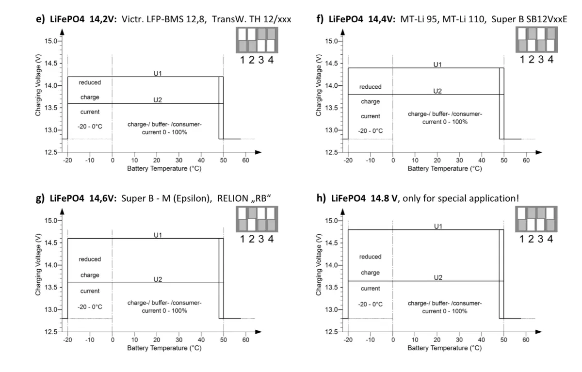

Have you got the Votronic MPPT charger manual? It contains a graph showing the effect of temperature on charging.

Looking at the charging graphs it says reduced current 0 -- 20° so not very good you want it to not charge at +4° or +5° like Victron do.

The Votronic manual for my MPPT says that
'LiFePO4 Batteries:
Effect: In case of abnormal battery temperatures, such as <-20 °C, >50 °C, the charging voltage will be reduced strongly to
safety charging voltage, approx. 12.80 V, for battery protection, and the maximum charging current rate will be halved.
Battery charging is then interrupted, but the supply of consumers being possibly connected will be continued by the solar
controller until the battery temperature is in the admissible range. After that, automatic charging will be resumed.
Below 0 °C, the charging current will be reduced very strongly for battery protection, and longer charging times can be
expected."
I am not sure what in terms of volts/amps " Very Strongly" means......
