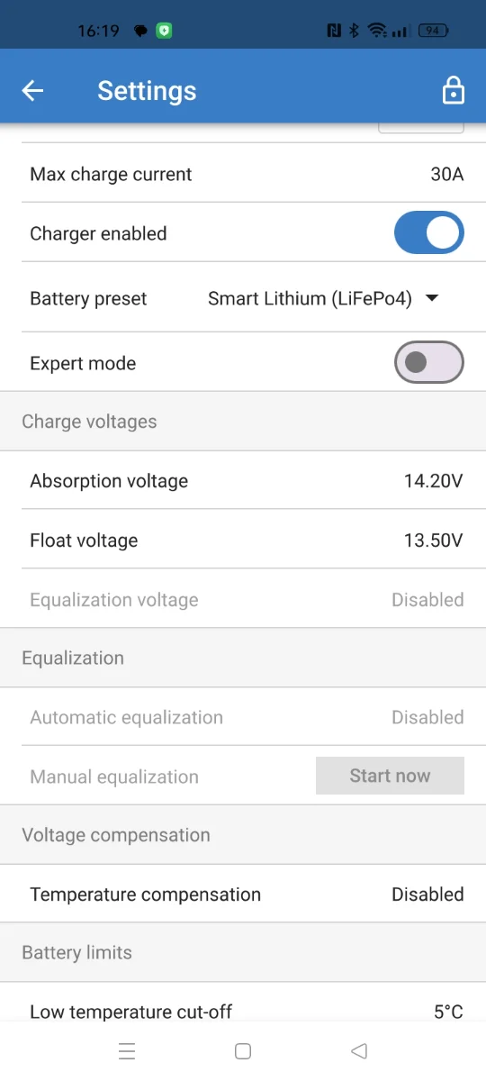

Sounds like the mains charger is set to AGM with those high voltages.
Been out in the van today and looked again at our Schaudt Elektroblok 119 and it does not have a lithium profile.Sounds like the mains charger is set to AGM with those high voltages.
Gel & Lead acid are the same voltage on an EBL just the absorbtion time varies.Been out in the van today and looked again at our Schaudt Elektroblok 119 and it does not have a lithium profile.
Its been taken off gel and set to lead acid.
The intention is to run off some battery tomorrow or tonight (it is now full ... properly full) and not have recharging on until I lose a good 50 amps somewhere and see what happens when she recharges from solar in terms of the high voltage and when she floats etc
According to Schaudt on google its ok to charge the lithium on it in lead acid mode and consider changing some optionsGel & Lead acid are the same voltage on an EBL just the absorbtion time varies.
Very very occasionally. 6 nights in total so far in 8 months and I suspect it will be none in the next 6 monthsIf you are only using EHU Occasionally it's OK but if using regially best to fit a proper charger with a lithium profile. Victron IP22 range are not that expensive.
