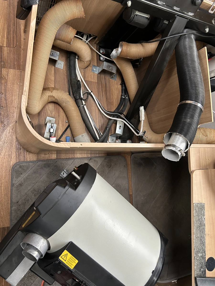

Noticed last Easter in France that the Truma Combi 4E I have was a bit rubbish on electric where it was usually fine.
On electric only with one element, it was doing nothing and a check with the ammeter confirmed it was drawing 0. Never bothered doing anything as the other still worked.
Fast forward and both are now not working.
Truma now only sell an exchange heat exchanger complete and it’s £500. :-(
However you can get the elements elsewhere for £150 so thought I would give it a try. I don’t want to open up the water or combustion chamber as the seals kit is another £70 so was resigned to pulling the elements out instead of being able to separate the fins.
Hardest thing was getting the heater out the van and in the house. I had expected the elements to be seized in as several people suggested they would be as they split and expand when broken.
I was pleasantly surprised when I pulled them out and they both moved. Only took light taps with a hammer to fully remove them.
One indeed had split and the other was also reading massive resistance so confirmed both were bust.
It’s all now back together and just waiting to be put back in.
Got everything crossed that it goes well and all will be working Monday. The replacement was much easier than I thought it would be and YouTube has several videos of the process.

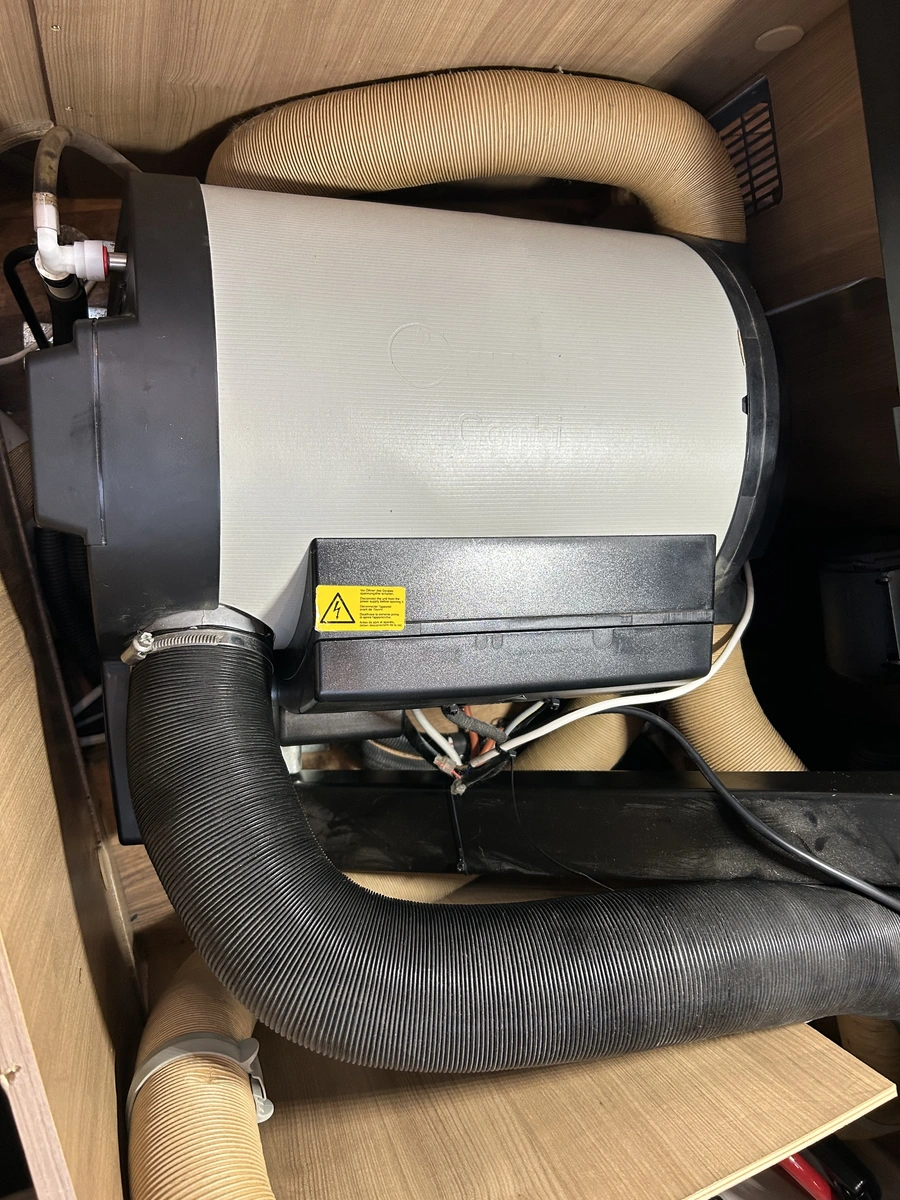

It’s all back together. :-)
Not much space to mess with but no issues at all putting it back.
Gas connection tested with leak spray and a gas sniffer and silicone grease on the water connections.
Pipes back in, flue connected and electrical connections tidied and sorted!
You can see where the old element has split, no wonder they can be a pain to get out. Thankfully the split was near the end on mine.
Turned on and gas working fine as it was before.
Electric turned on and now drawing the right amount of power with the water heating up. Both elements switching on and off as they should do.
All in all, it was a much easier job than I thought it would be and well recommended if your elements go down.
With metered electric coming to more places, it might not be worth it eventually, but for £150 it was worth fixing. 👍
