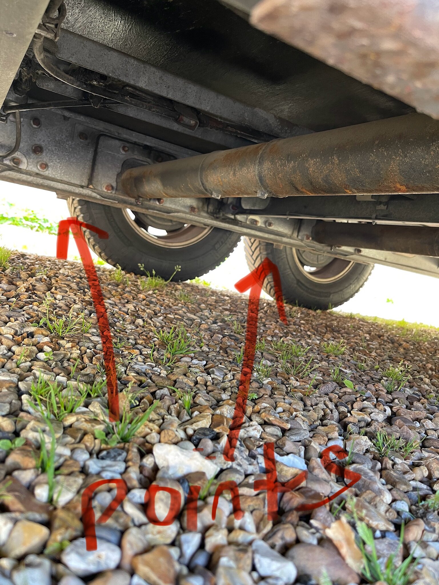

Burstner 747-2 jack up points front and the two back ones.

Is there not room next to the jack point? Looking at the picture I added.
