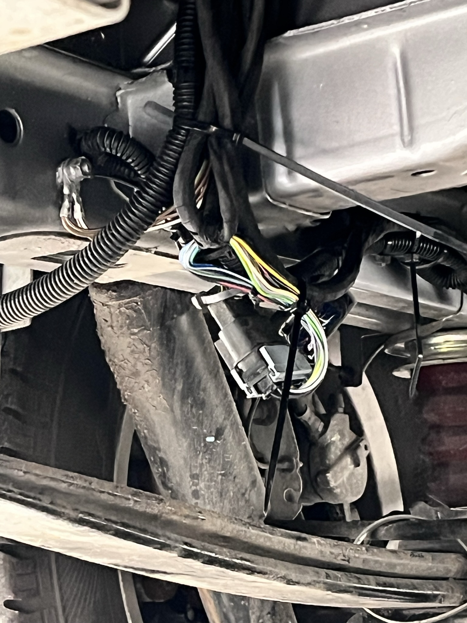

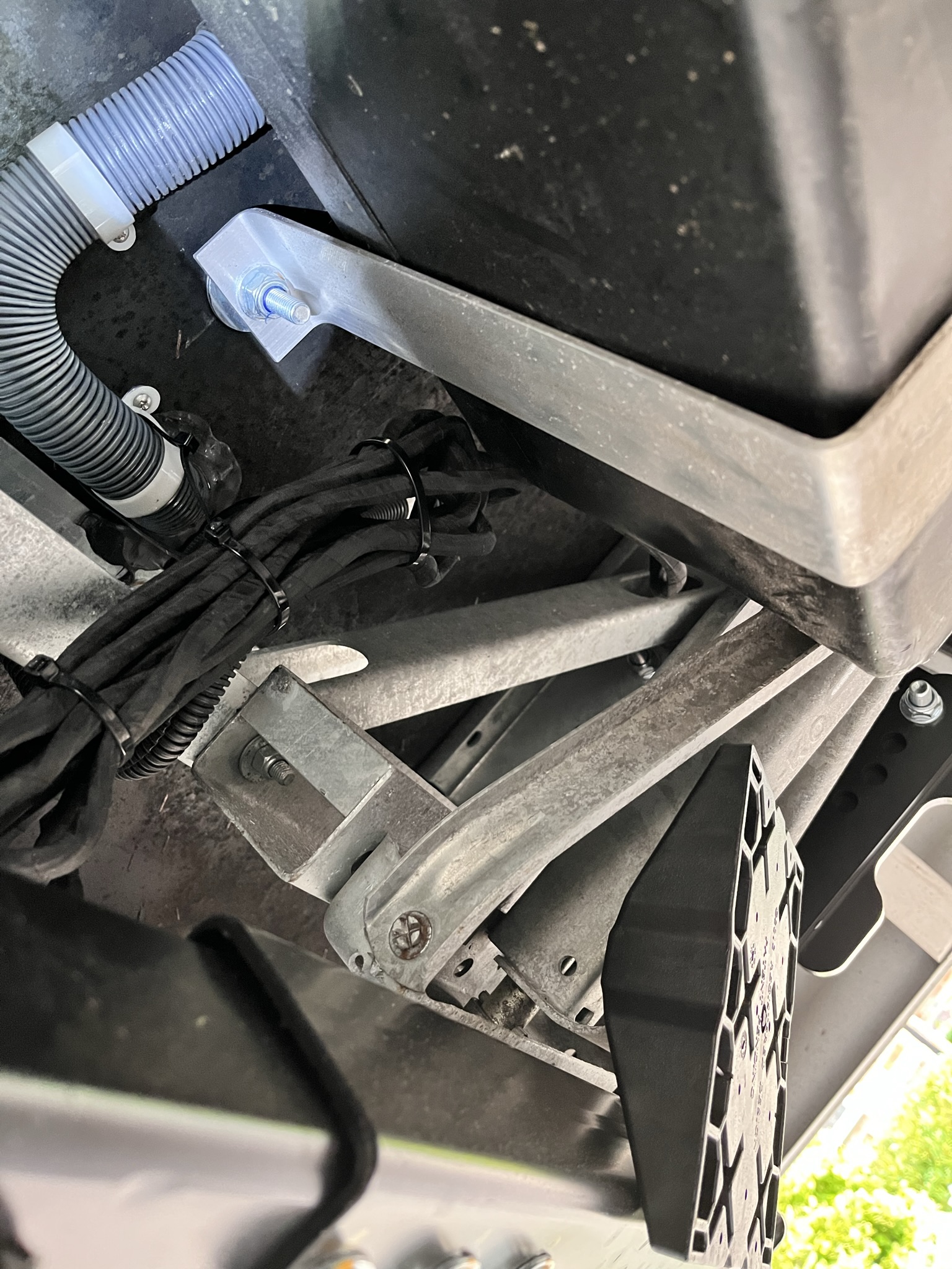

Recently had a towbar installed by local person and looking at the underside, I dont feel the quality of the cabling / conduit work is that good (bare cables and connectors, cable ties not cut off). Given that I spent £850 on the install, I am pondering whether to make a complaint and have him tidy this up. What are your thoughts?

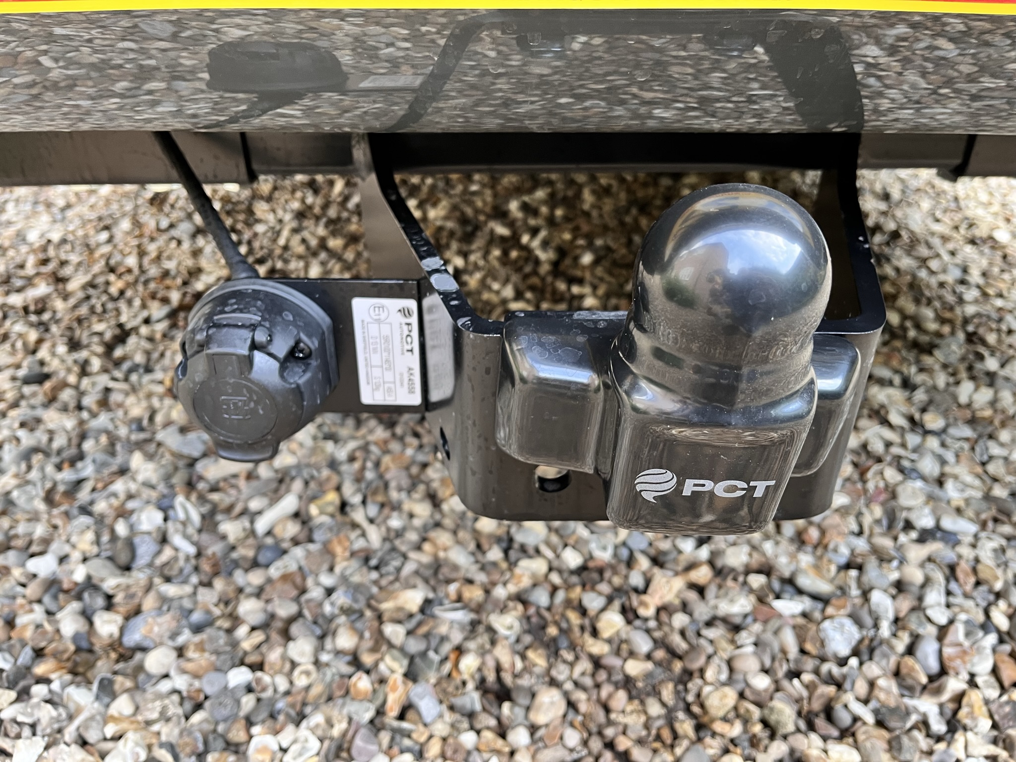

Also the towbar is very close to the back of the van, is there anyway that this can be extended so that my bicycle carrier with bikes handles do not touch the back of the motorhome?

I don’t see anything horrendous and would make sure the joints/connections are well sealed, with something like dielectric grease. I wouldn’t seal them in a bag or plastic as they will just sweat, and not be able to dry as not exposed to the air.
As said above you can get tow bar ball extenders, or swan neck tow ball that will move hitch outward.

Is there any disadvantages to towbar extender? The cables look like they could easily get caught and pull out.

The disadvantage to extending the TB is that you are moving the weight out which isn’t ideal for heavy towing, but won’t matter for carrying bike.
Id just tidy up the cables. Unfortunately that is the UK standard of work these days, and that’s why I do my own stuff. My TB electrical junctions are inside the van to keep them out the way and dry.
Was his name J.Wayne ?
Electrical connections for a tow bar should be inside the van.. not underneath .. that's just lazy.
Where is the bypass relay fitted and there there should be a flasher buzzer.

Personally I don’t like “swan neck” tow balls. Especially if you’re going to use it for bike/scooter racks. Far too weak.

Looking at the cable he has used it's a cheap trailer wiring kit he has used with undersized cables that don't meet the regs.
You can get spacers to space the towball off up to 2" but technically illegal on an approved towbar.

Yes but post 2012 unless the towbar was homologated with them they are not legal

& as above unless homologated with additions they are not legal

If not homologated to the actual bar they are not legal

If you’re worried about the wiring being exposed to the elements get some self amalgamating tape from the likes of screwfix and wrap it round the wiring. Excellent stuff! I used it as a “get me home” fix on a radiator pipe on a morris minor (don’t ask!) and it “got me home” for 6 years! That was keeping the water IN but you get my drift. Cheers! Russ
