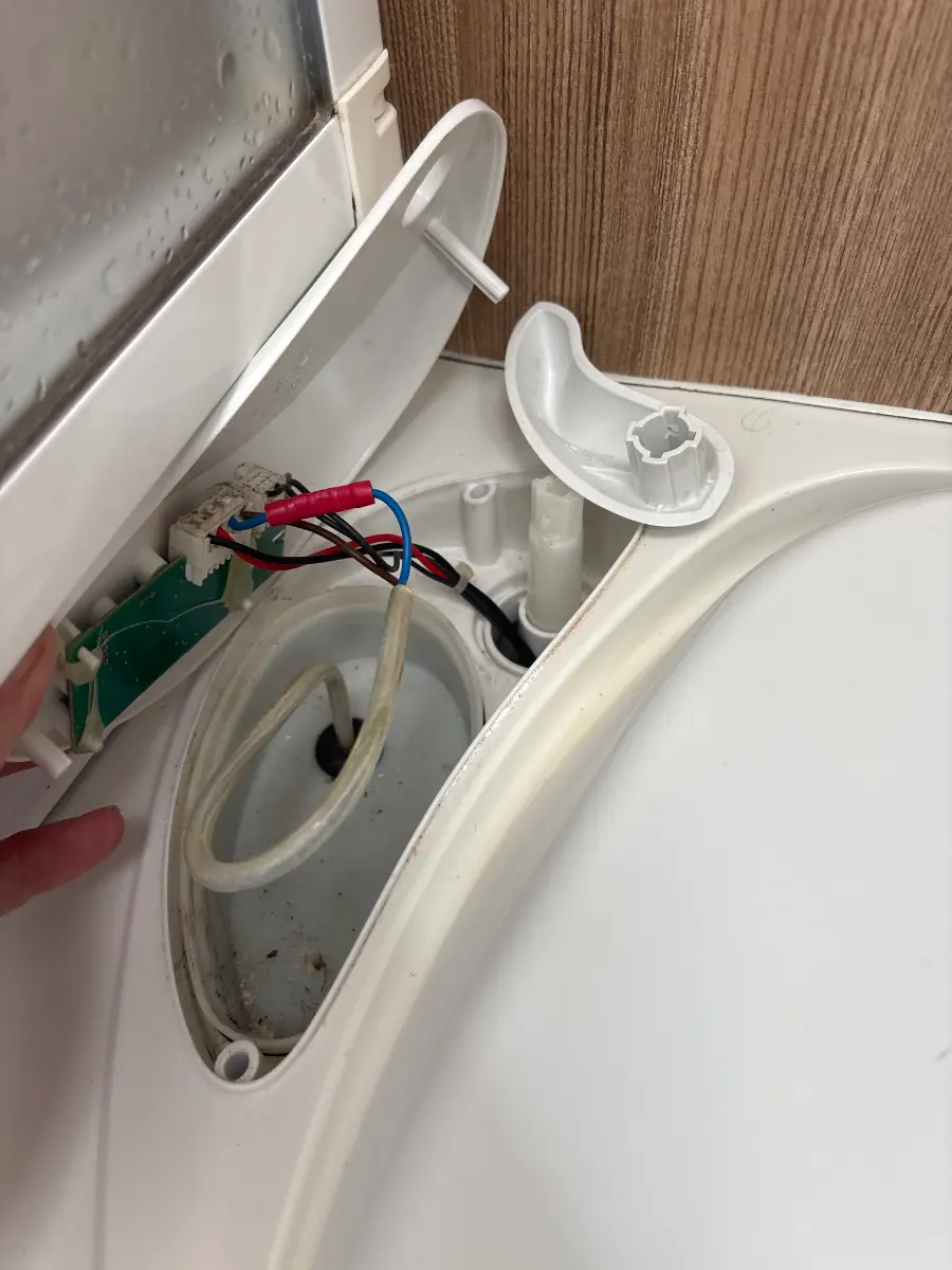

No fuse blown. I guess it’s under here??
Just looking at the picture I would check the red crimped connector they do have an habit of corroding or coming adrift.
kev54 No the fuse isn’t in that water tank. From memory if I reached into the cassette cavity from the door & on the right hand side a spade fuse pushed vertically upwards. You would not have noticed it if you were not told where it was. I think it may have been a pink one, it’s only very small at 2/5 amp I seem to recall. You are fast seeing it using a mirror inside the cassette space.
That white dish shown in your photo with the electric wires going through it sepearates the handle from the tank. Carefully lift it out by pressure to each side whilst pulling up. It then reveals the tank below that is filled from the outside and the pump. You can hopefully just get your hand through to get the pump which sits it the bottom.
