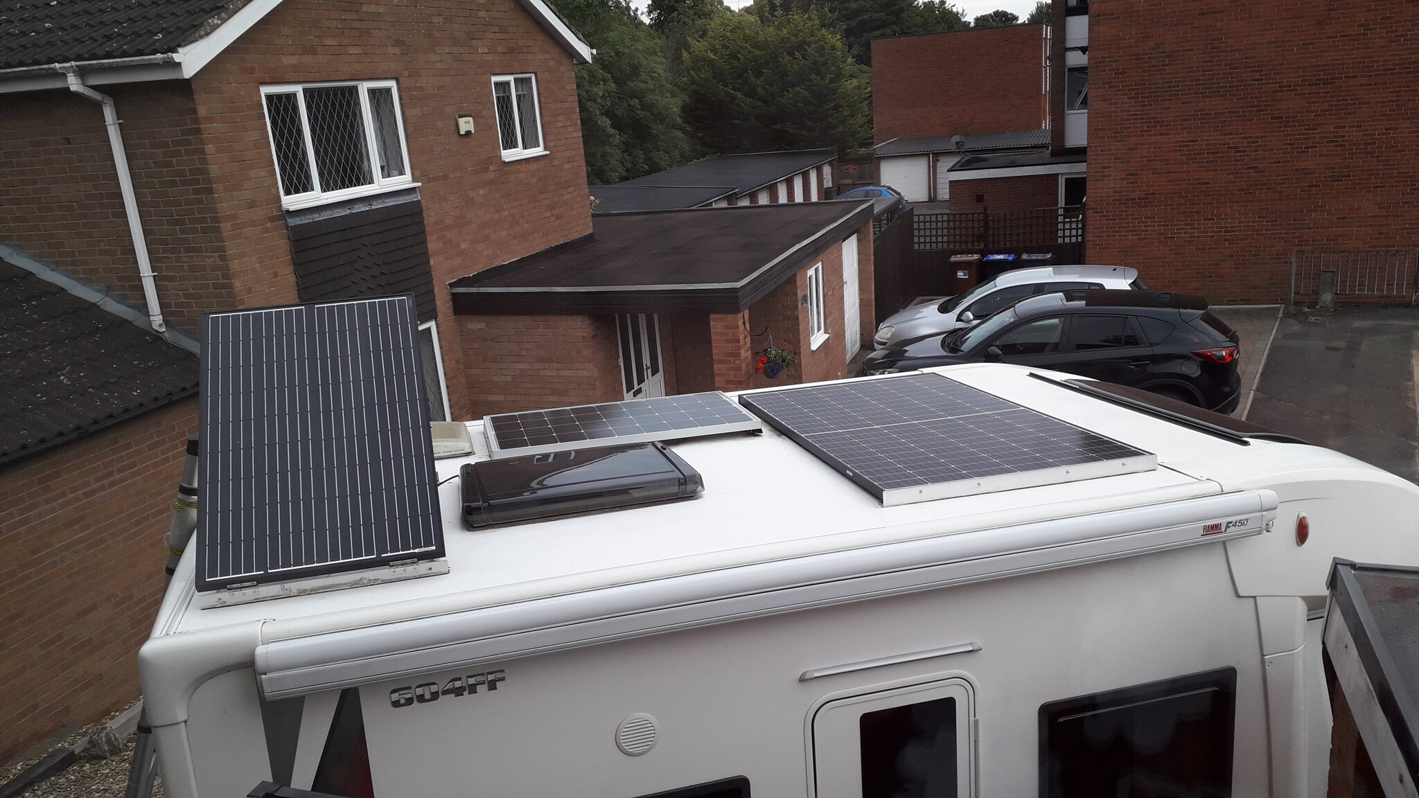

My roof panel is fastened down onto aluminium channel with 4 stainless hinges, I made the pins removable so the panel will hinge up either forwards or backwards

My roof panel is fastened down onto aluminium channel with 4 stainless hinges, I made the pins removable so the panel will hinge up either forwards or backwardsView attachment 943829
