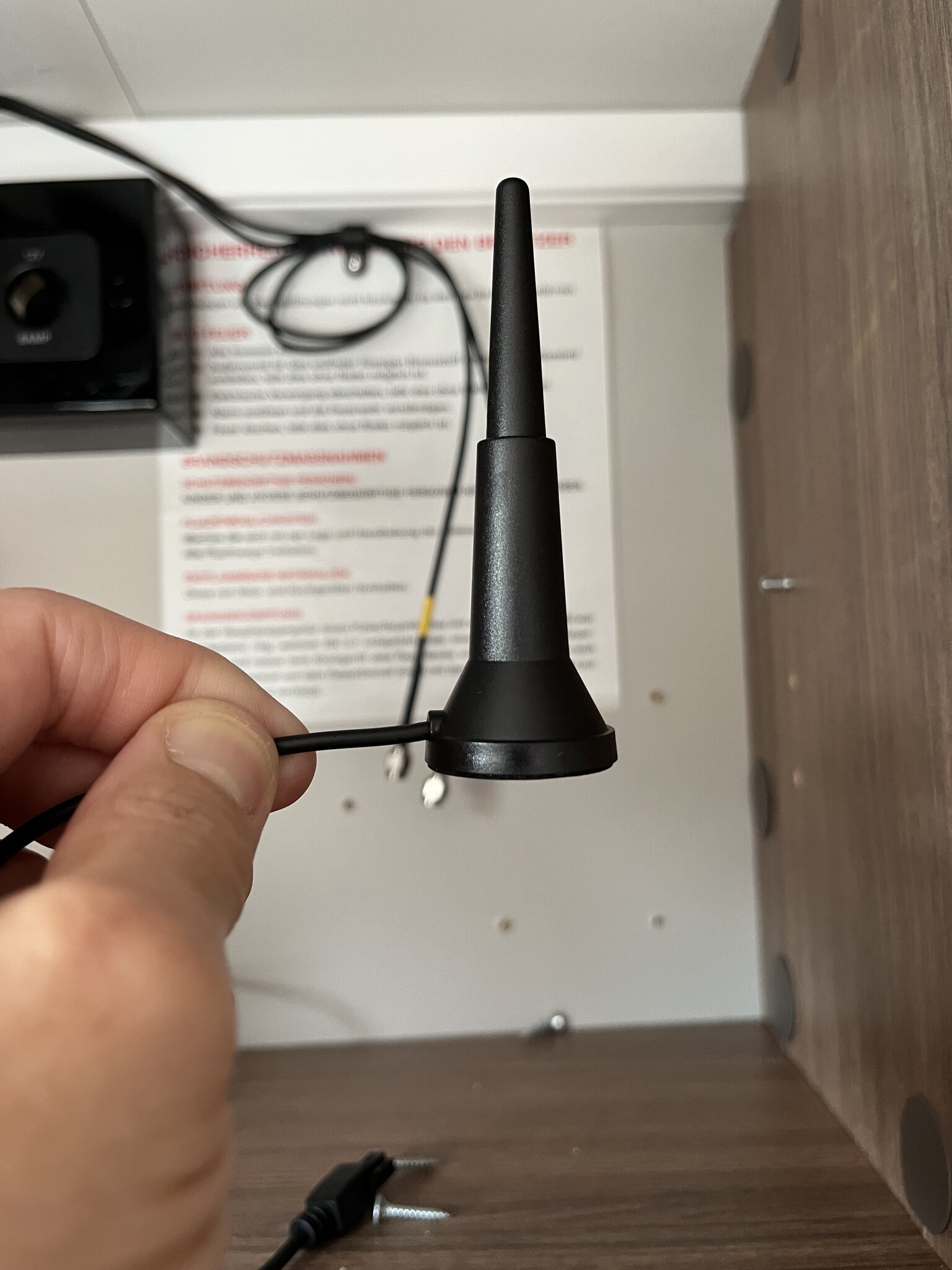

The antenna’s, as I only have two wires coming from the roof, and I have 4 inputs, I’ve connected at either end of the inputs. So I’ve connected to 1 and 4 leaving 2 and 3. Is there any benefit to connecting the bundled antennas to 2 and 3 or just leave them empty.
There is gps antenna included, is that worth connecting?
Lastly there are 2 wifi antennas as there any recommendations to placement inside the van or at different angles, say one horizontally and one vertically?
I’m sure I’ll have more questions!

Not sure about the mobile antennas. I think the unit expects anything that's connected to be identical. But it might be worth experimenting.
WiFi, I've got them connected to the external antenna. Although I'm not sure that's the best for van use. I think as they've mainly for communication into the van, internal ones should be fine. I've never tried relaying a WiFi signal from a campsite's network though.
GPS is only any use if you're using some of the tracking functions with a Traccar service or similar. I've not got around to playing with it yet.

I found that with my old external antenna with 2 wires coming in, the mobile speed was better if I also connected the supplied stubby antenna to inputs 2 & 3 so try it (Note that Teltonika refer to the inputs as 0,1,2,3 so be careful if you read info on other sites :) ).
With the Wi-Fi antennae, think of them as having a kind of circular 'Halo' of coverage coming out of the stubby top; if you mount them 90 degree's inverted, then it changes the coverage pattern .. although, lets be honest we're talking small coverage area in a van so I don't think it would make a blind bit of difference, but may affect distance from the Van.
Yep, my SIM trays are a right pain and a couple of times I put them in upside down and had to shake the hell out of the unit to get them out again
You're best of carrying on and doing your own testing - Find a CL near a good Pub for a proper 'field trial' 💪
(I did attach the GPS antennae, although not actually found a use for it yet..but why not?!)

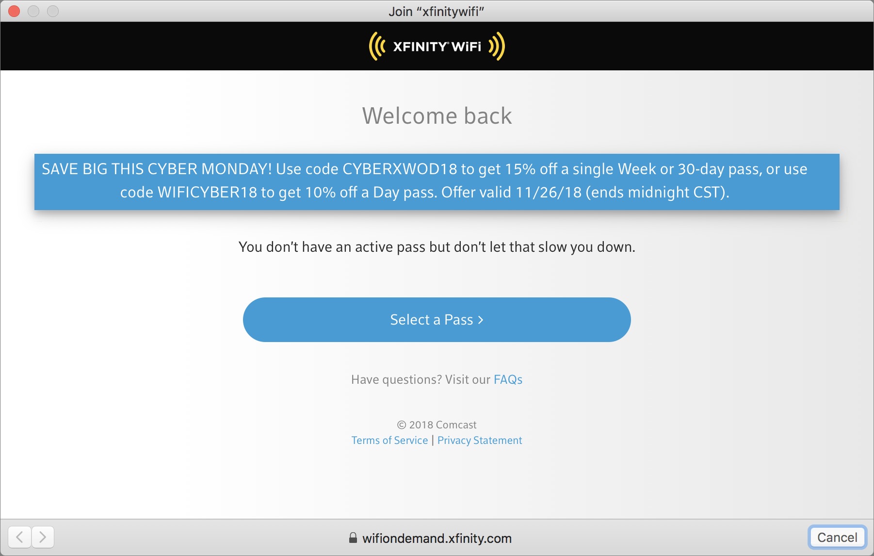

On the external wifi connection to, say, a campsite's wifi, although I've seen the Teltonika instructional video, I don't find it easy to understand - especially how much bothersome intervention may be needed to change from 3g/4g to wifi and back, when moving from one camping location with site wifi to the next one where there's onle 3g/4g. Do you need to adjust the router's Interfaces table and reboot it?
Can anyone help with this?
I've used the RUTX50 a few times to pull in the campsite wifi where there is absolutely no 3G/4G signal and broadcast it inside the van, but it can be fiddly to get setup.
There is an extra package you can install onto the RUTX50 which is supposed to add functionality to cope with captive portals (e.g. log into campsite wifi/accept T&Cs), but not managed to get it to work properly yet.
The alternative I used may be too gnarly for most funsters:
  1. Log into the campsite wifi with my MacBook
  2. Accept the T&Cs
  3. Grab the MacBook MAC address
  4. Get the RUTX50 to spoof the MacBook MAC address
Here's a little guide on how to do 3.
If you only have a 2x2 antenna (i.e. 2 leads) , Teltonika seem to suggest connecting to either ports 1&4 or ports 2&3.
Then you may find it beneficial in terms of speed to connect one of the Teltonika 'out of the box' antennas to the unused cell ports, even with the antenna just left internally within your van.
According to Teltonika:
"The two outer antennas on the RUTX50 are responsible for the lower frequency bands, while the inner ones are responsible for higher frequency bands, as well as 4x4 MIMO"
