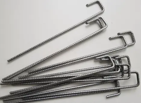

I then only need two pegs, which are boat mooring steaks made from 30cm of rebar.
Put in with a rubber mallet.

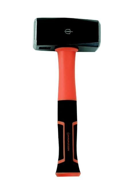

Anything that screws in and an electric drill would, I think, be the ideal civilised solution but meanwhile I advocate the lump hammer method.
I used to think they were a bit ott & mainly for macho types who already used them in the blacksmithy where they worked but passing one in B&Q I just felt the urge one day & never looked back.

I just use big steel pegs and a lump hammer. I've occasionally had to lend my hammer to other campers but have always 'supervised' to make sure I get it back.

I bought rock ground pegs last year and invested in a 1kg lump hammer, problem was solved. I also have a handful of screw pegs for when the awning reaches onto grass.

And rock pegs like these with a claw hammer on hard standing, both in conjunction with storm straps.
10 Pack Tent Pegs Metal Heavy Duty Camping Pegs Hard Ground Tent Pegs Awning Pegs Rock Pegs for Awnings Hard Ground Hard Standing https://amzn.eu/d/3yqO3U2
Mix of rock pegs with lump hammer and mallet with tent pegs depending on ground
