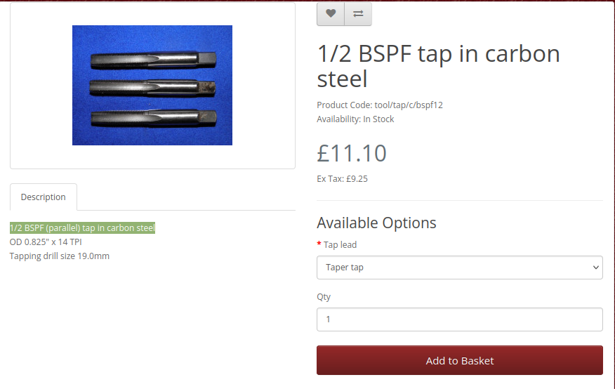

Just looked at that set again and realised it was a taper set not a parallel set. Cancelled. They all seem to be taper threads on amazon grrr.
Oh Jeez. Seems the sellers don't understand or maybe I don't. I have never dealt with BSP before
But apparently it comes in two main flavours parallel and tapered.
Taps for cutting the holes also use the tapered terminology as in tapered, 2nd cut or plug.
So I am actually looking for a tapered 1/2" parallel BSP (BSPP) tap.
Seems a lot of sellers don't understand to put in parallel or tapered as the thread type as well as which type of tap.
The only supplier I have found so far that is reasonably priced that appears to understand this is a steam model train company.
You can't have both in one.....like asking for a dry wet towel.
You first pic is parallel, the set in the link is taper.

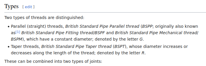

You perhaps misunderstood me or I didn't explain myself well.
There are 2 types of BSP thread. Tapered and parallel.
There are 3 types of tap tapered, 2nd and plug.
So you can have a tapered tap for a tapered or parallel thread.
I am after the BSPP not the BSPT taps. That multipack I ordered was BSPT threaded.
BSPP taps will normally come with a 1st cut (tapered) and plug for the final parallel thread. Trying to start a plug tap without the 1st cut is quite difficult.
BSPT taps can come in sets still with the 1st cut providing a starting thread before finishing with the 2nd tap although not always as in some instances you can get away with just the one tap.
Parallel threads are normally used with a sealing washer (Copper, bonded or Dowty) underneath the head of the fastener.
Tapered threads are generally used where the mating thread provides the seal, possibly in conjunction with thread tape.

So there are definately 2 types of BSP thread and I need to ensure I get the right tap. That was what I was saying (y) :)
Yeah, it can be confusing at times, especially when vendors use the"taper" terminology instead of 1st, second and plug/bottoming tap ?
BSPT is usually used on steel pipework and it relies on the tapered male pipe "interfering" with the corresponding tapered female fitting to provide a "mechanical" seal, although you generally help it along with some ptfe tape or "pipe dope"
BSPP is generally used on fittings that screw into manifolds/valves etc and require a "mechanical seal" such as a copper washer or an O ring to provide their integrity and are often used in high pressure hydraulic systems.
Depending on your needs and whether you actually need a competent gas/liquid seal, you may be able to get away with a bit of "mix and matching" ?
A BSPT tap threaded all the way through your job and out the other side may leave a BSPP thread (best to try a dry run first though !) (As pappajohn was alluding to ?)
Then you can throw American NPT threads into the mix, which are similar to BSP, but have a 60° thread angle instead of the 55° Whitworth form of BSP.
