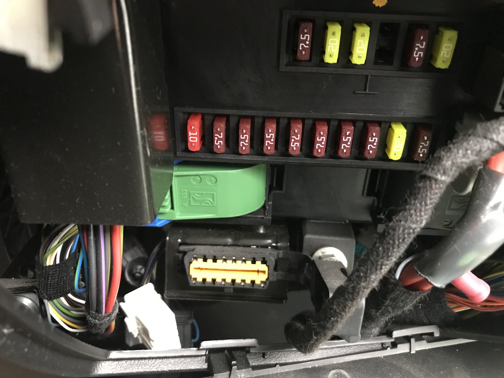

Does anybody know is there a indicator fuse for the swift Bolero, I have changed the bulb on the rear of off side, checked the wires
Still not working and my arm is getting tired waving up and down šŸ„µ I have attached a fuse box photo
Many Thanks again
I think you will find that there is not a fuse for the indicators but the supply is controlled by the BCM , it may be worth checking that the bulb holder is ok also that the replacement bulb is the correct wattage.

Jeff one take it from somebody that knows. Cheap replacement bulbs are the work of the Devil. You think they are good, but just refuse to work because the BCM sees a fault and switches off the power. Too many times I have seen the same issues
Hi and thanks again
Tried right bulb, even swapped over and nowt,, checked for loose wires,,, it needs a pro I think šŸ¤”
if the bulb is good 90% of light issues are down to a bad earth.
