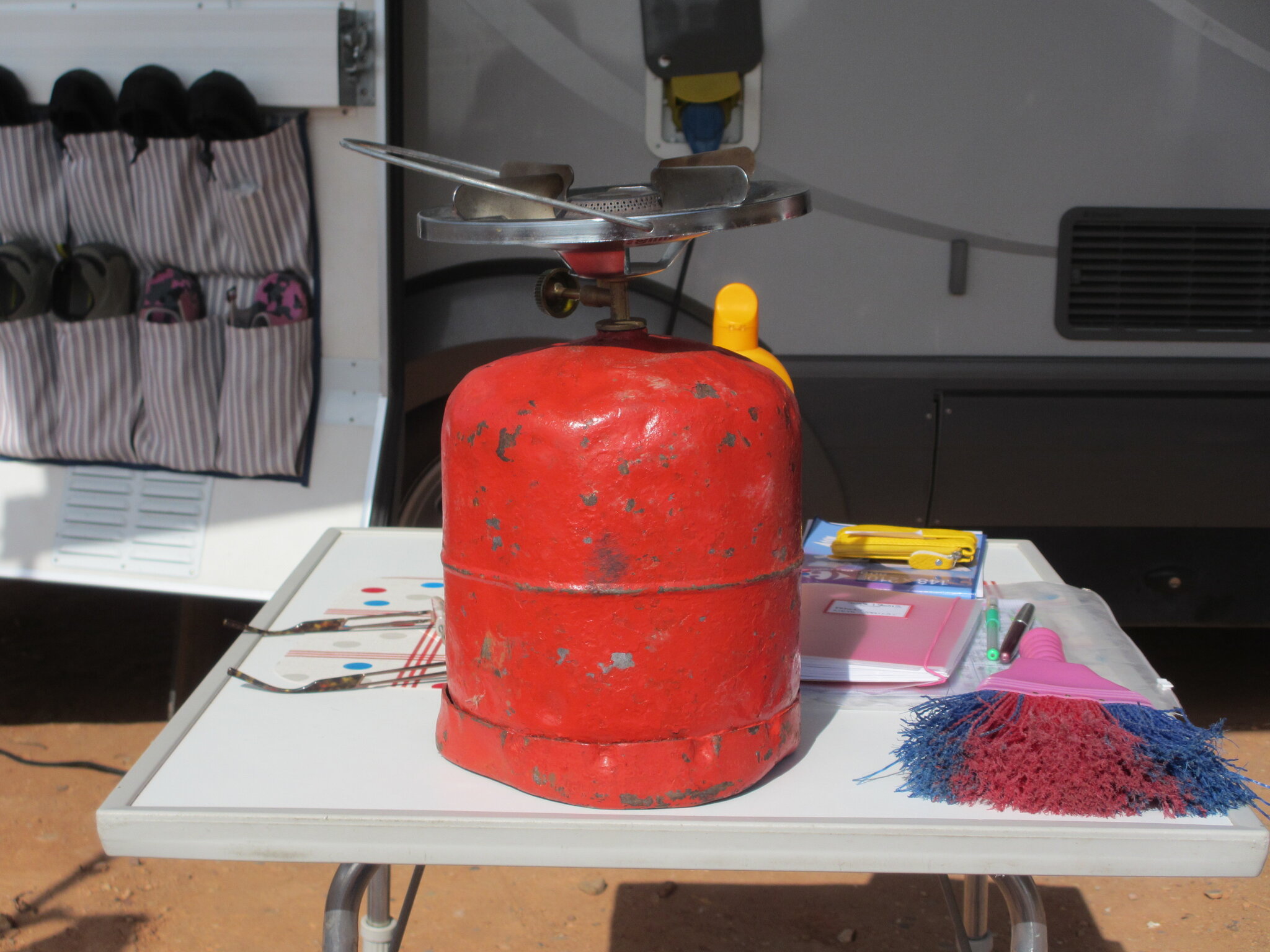

Not official bottles but you can get 'recycled' campingaz bottles that are ridiculously cheap, some have seen better days though, this one we used for cooking on a slope. :giggle:
Pete
Thanks Pete.
