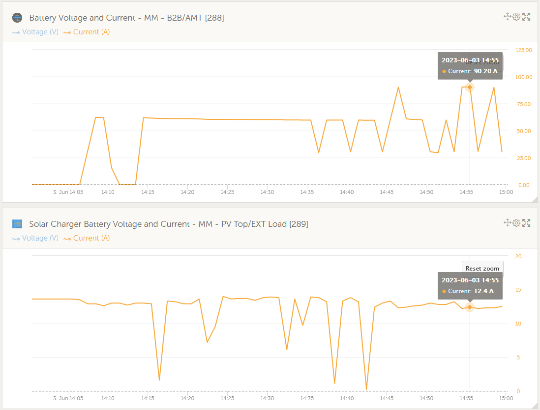

BOTH will work. It is that simple.
Top Chart is the current from my B2B kit. Bottom Chart is the output from my Victron 100/20 MPPT Controller.
Even though the B2B is sometimes putting out a pretty good current, it is not stopping the Solar from joining the party :)

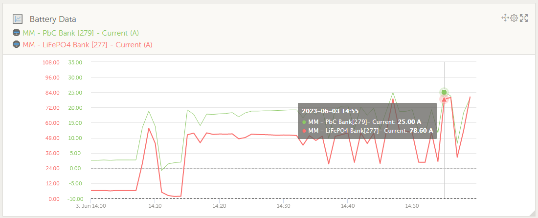

The chart I posted was the output from Solar and B2B chargers. This chart for the same time period shows how much charge is going into the Lithium Bank and the Lead Acid Bank. The Batteries could accept more if it were available.
(the reason for the fluctation is the alternator output varying depending on the engine speed. My B2Bs are tuned to be active at certain voltages to try and optimise output whilst not overstressing it).
