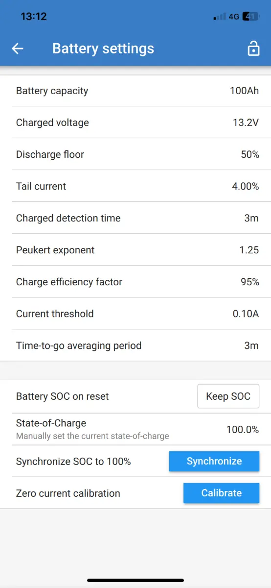

No Settings attached :)

Voltage setting way too low.

What absorption voltage setting do you have set on the charger? Normally I would use 0.2v lower than absorption for the Charged Voltage setting on the shunt.
Once you have hit 13.2v as set on yours the shunt will use the tail current of 4% of the AH setting so in the case of a 100AH battery 4amps to determine the battery is full, this condition must be met for 3mins (Charge detection time). So with Solar that can mean that as the sun rises the solar puts out a small current, enough to raise the battery voltage to 13.2v, if the current stays at 4amps or less for three minutes, the shunt sets to 100%.
If the charged voltage is set to 0.2v below absorbtion, say 14.5v for agm with 14.7v absorption, the shunt is less likely to got to 100% early, especially on an EHU type charger - with solar there is always a risk of low output I guess. Mine (Lithium) is set for 2% currently, on a 430ah bank.
Charged voltage needs to be around 14.5v and charge efficency 75/80%.
Your settings explane your odd readings.
With lead batteries you need to tweak the settings and until the SOC reads correctly.
On my last van with Gel batteries I spent a couple of weeks discharging and recharging the batteries between tweaks to get it reasonably accurate. You will never get it much more accurate than 5% with lead.
Also for each year of battery age you need to reduce the battery capacity by 2.5%.

On the solar controller absorbtion 14.7V, float 13.8V. (from the Victron AGM profile example)

absorbtion = 14.7V, float = 13.8V (adopted from the Victron AGM profile.
Thanks all, that really helps. It was obvious from the current profile that the SOC reporting was off. I haven’t put too much effort into tweaking the AGM settings as I’ve not had this van that long and have been planning a change to Lithium (in the next couple of months now 😁).
