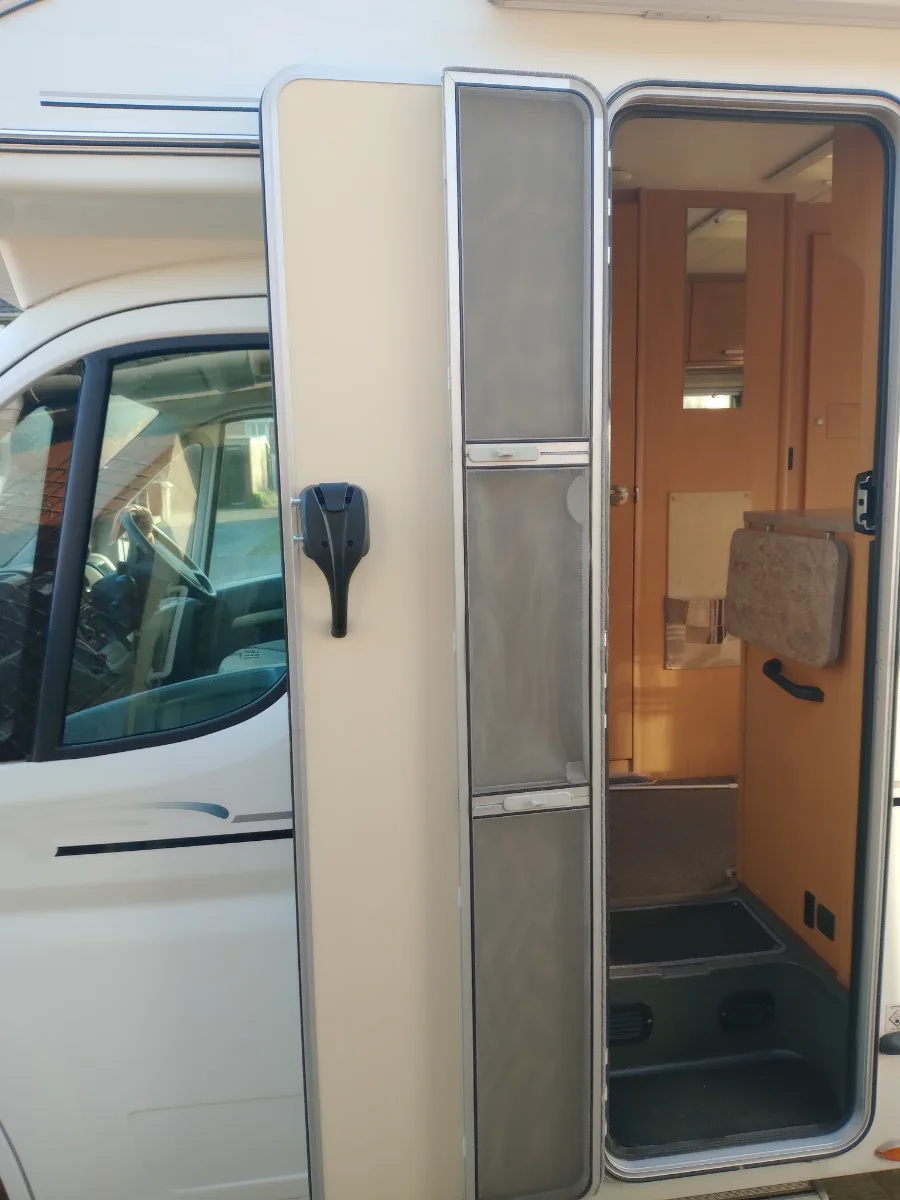

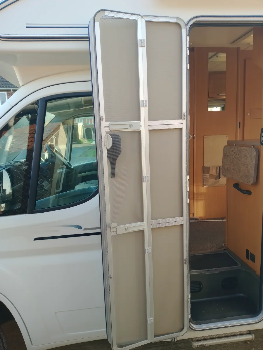

The van is 2012 Elddis Sunseeker 140. I got it one week ago. The fly screen is attached to the door with a push in catch. I'm confused as well haha. It's in for vehicle service today but I will take more pictures when it is back home. Thanks.
3 Pictures. 1 is screen door closed and clipped to door. 2 is clip that fastens fly screen to door (when it is not seized). 3 is screen unclipped from door and open.

I'm not quite following this, in the first pic with the door open, the hinges for the fly screen must work or you wouldn't be able to open the door, you sure there isn't a catch hidden away somewhere ?
In your picture, hinge X is for the screen and hinge Y is for the door, but they both appear to pivot on the same pin which makes me think there has to be a hidden catch or snag ? 🤷‍♂️
Hopefully the dealer can sort it out without having to dismantle everything and drilling out those rivets ?

I released the catch holding them together. I think X is the one that is seized and will not rotate on its own. I'll keep you informed of my progress, is any haha

I haven't got a clue to be honest. My thoughts are that X is zeized to the pin

The pin moves in the 3 hinges that are attached to the door but is seized in the 2 hinges attached to the fly screen.
So instead of the door and screen hinges being able to move independently of each other they move as one allowing the door to open and close freely but the screen is seized against the door.
It's just caused by lack of use of the screen.

Hit the nail on the head. Thanks
