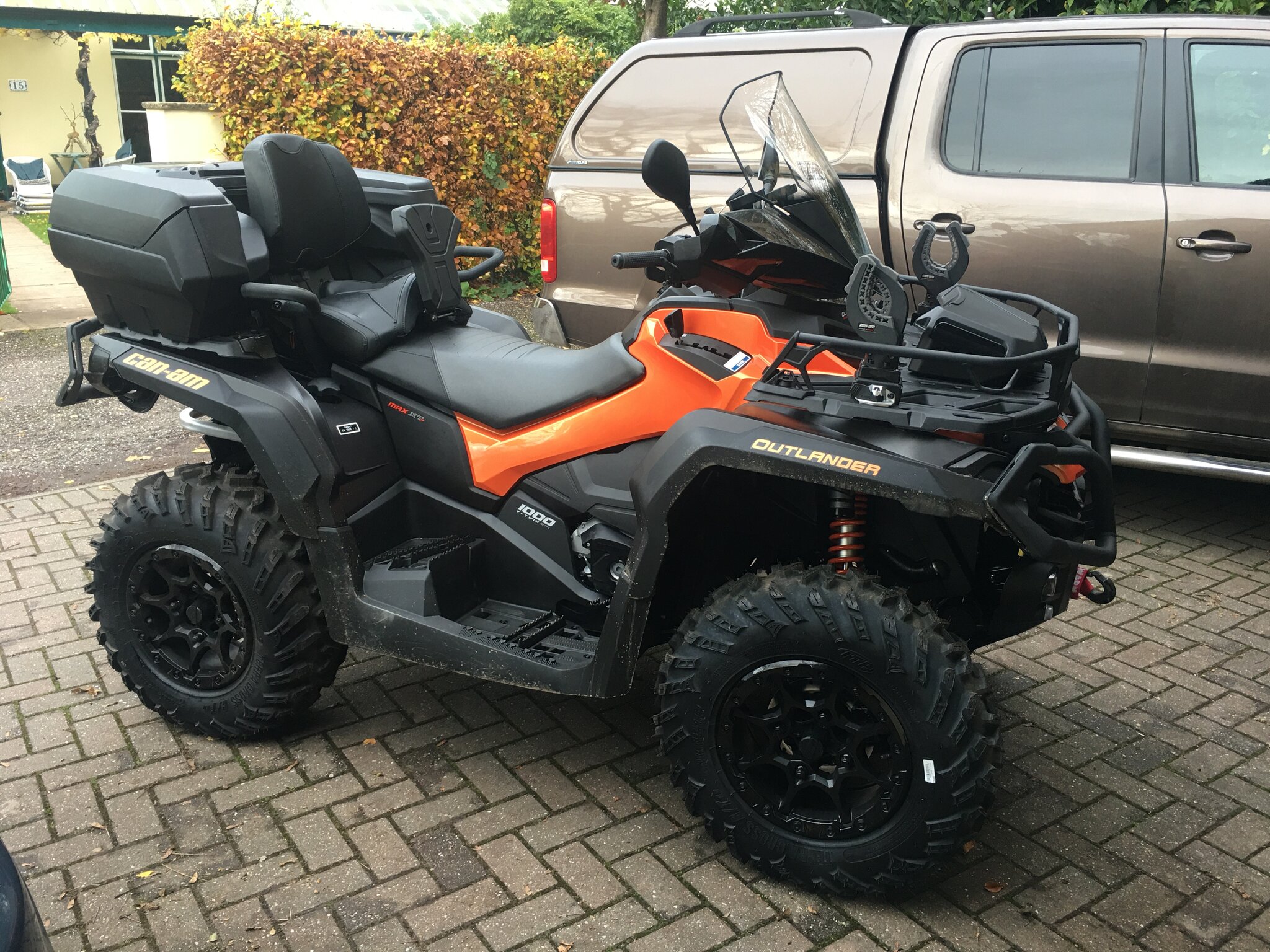

I’ve fitted a set of the Erickson tie downs in the trailer to secure my 1000cc Can Am quad.
That’s specifically for quads etc but no reason why they wouldn’t fit the wheels of a small car. If not then Erickson also have other E-Track components listed - scroll down on the link.
I think for a car the chocks would need to be bolted through a chassis member, just my opinion.

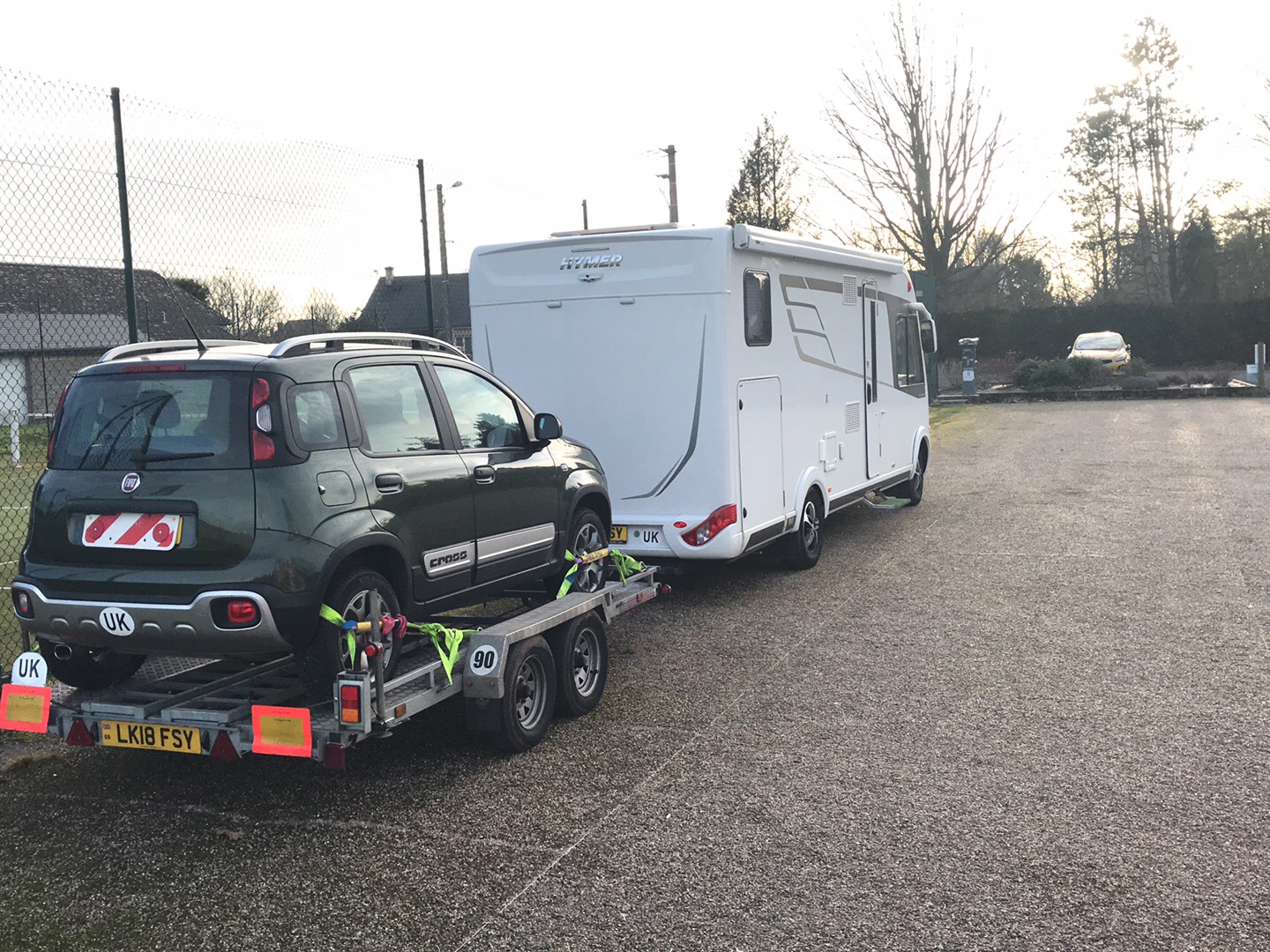

Nice, looks very secure and a nice sturdy trailer (y)
How long does it take you to load and secure if you don-t mind me asking ? Speve
I can do it in about half an hour although it usually takes a bit longer on site as folk usually want to talk etc.
