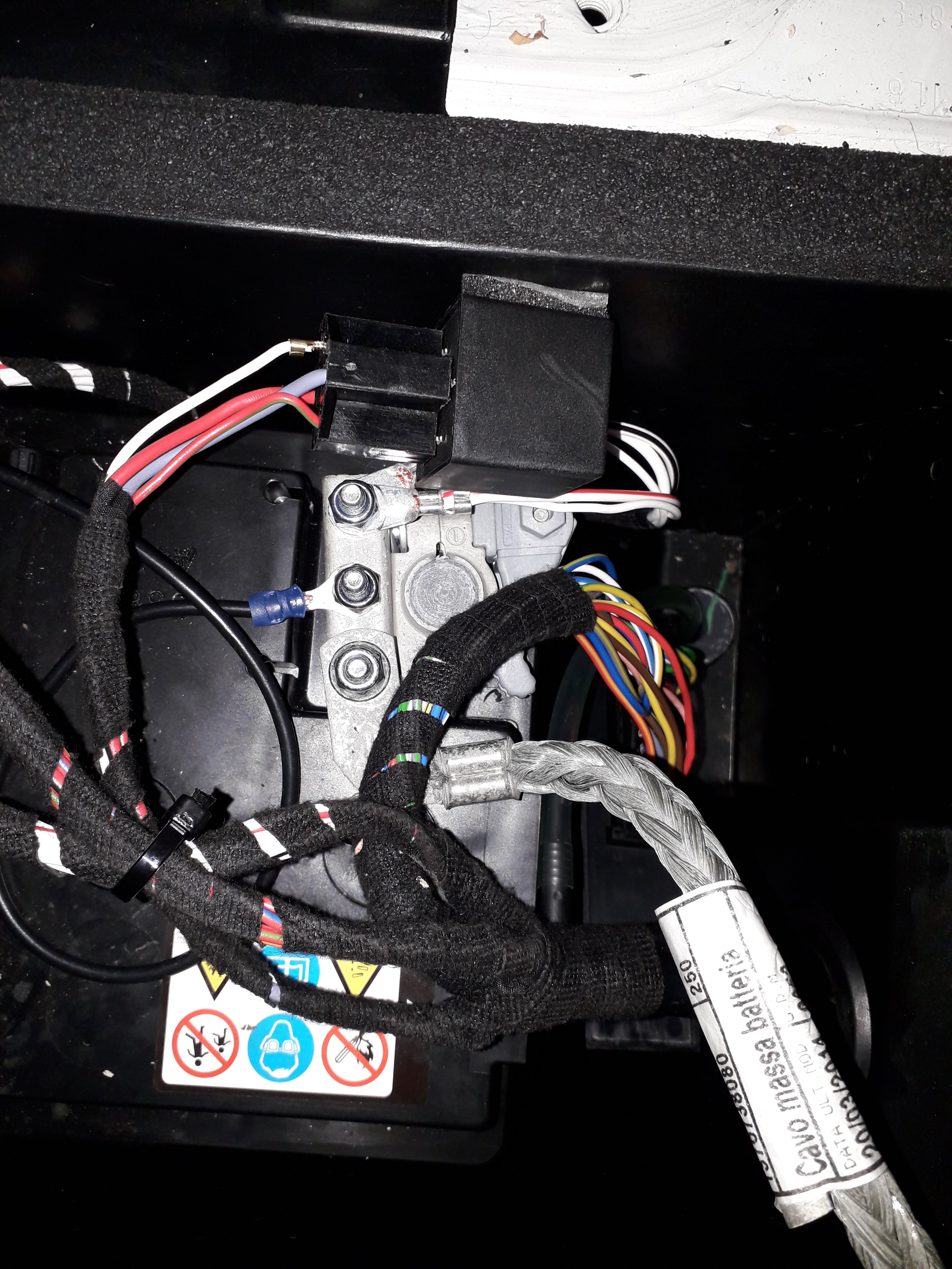

cab-battery1.jpegCab-battery.jpgCab-BattteryNeg.jpgNote My Battery has extra fuses and gubbins for towing Electrics.
Now remove the terminal cover at the Positive end.
Remove these two screws and the red plastic retainer.
Now slacken the Positive clamp nut using a 10mm ring spanner and lift the lot clear.
