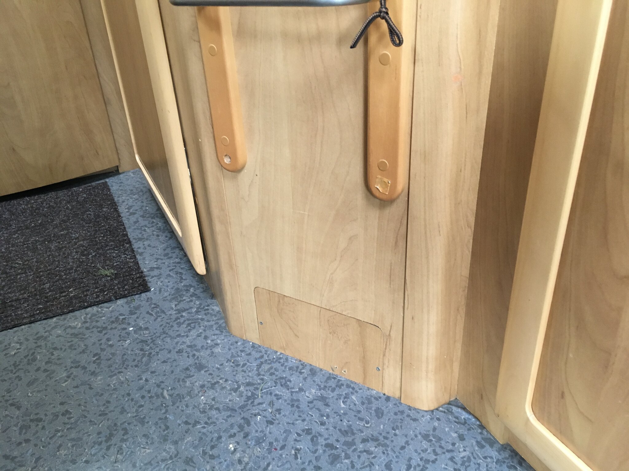

This is the access panel for our grey tank sensor on our 2001 B584, this is between bathroom and wardrobe door.
This is the access panel for our grey tank sensor on our 2001 B584, this is between bathroom and wardrobe door.View attachment 797029
Hi and many thanks for your input, unfortunately I tried that little panel but that only hides one of the waste traps to the shower, I also think that our tank is a little further back, towards the rear end
