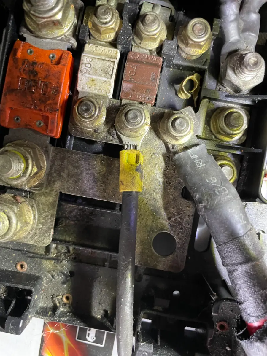

Following some recent starting difficulties on my Hymer B654 I want to remove the starter battery and clean up the various connections and fuses to the positive side and the earthing system connected to the negative side. However, I have a Sigma S30 security system fitted and I’m a little nervous with how it will react to being without power for possible a few days - should I be?

I posted a short description of the positive battery terminal distribution block recently, may be of interest (post #5):
There is a shaped piece of metal attached to the battery terminal, and one end of all the link fuses is attached to that. There are other bolts in that piece of metal, to attach wires without fuses. Presumably there will be inline fuses in those wires, very near the battery terminal.
I can see that on your distribution block, there are wires attached to the fuse bolts on the battery terminal side, ie before the fuse, not after it. Ideally those wires should have been attached to one of the several free bolts on the shaped piece of metal. But attaching them to the battery end of a fuse is OK electrically, it just might be a bit confusing if you're trying to work out what powers what. Just check that there is indeed a fuse on each wire that is attached in this way.
