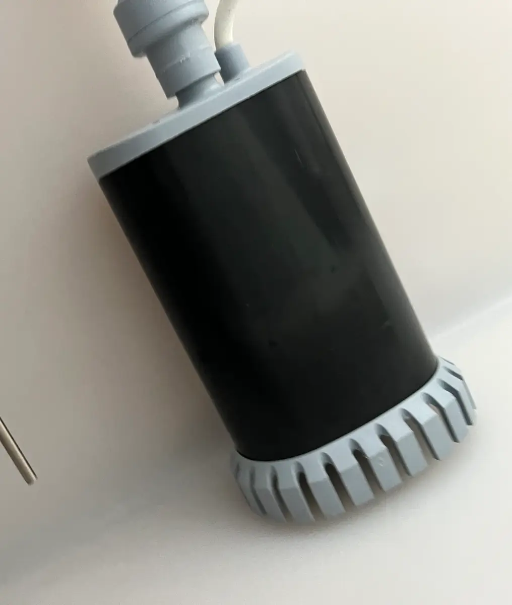

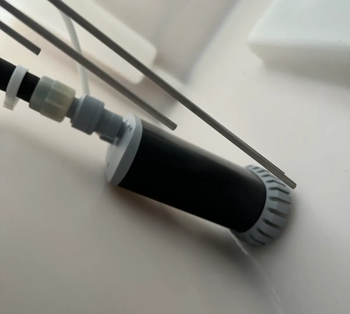

I’ve managed to take some photos of mine
Is this a reich one do you know ?
From your photos it looks the same as the one in my LMC motorhome which is the reich twin motor 19 litres per minute. I purchased one from eBay last year at £54.00
