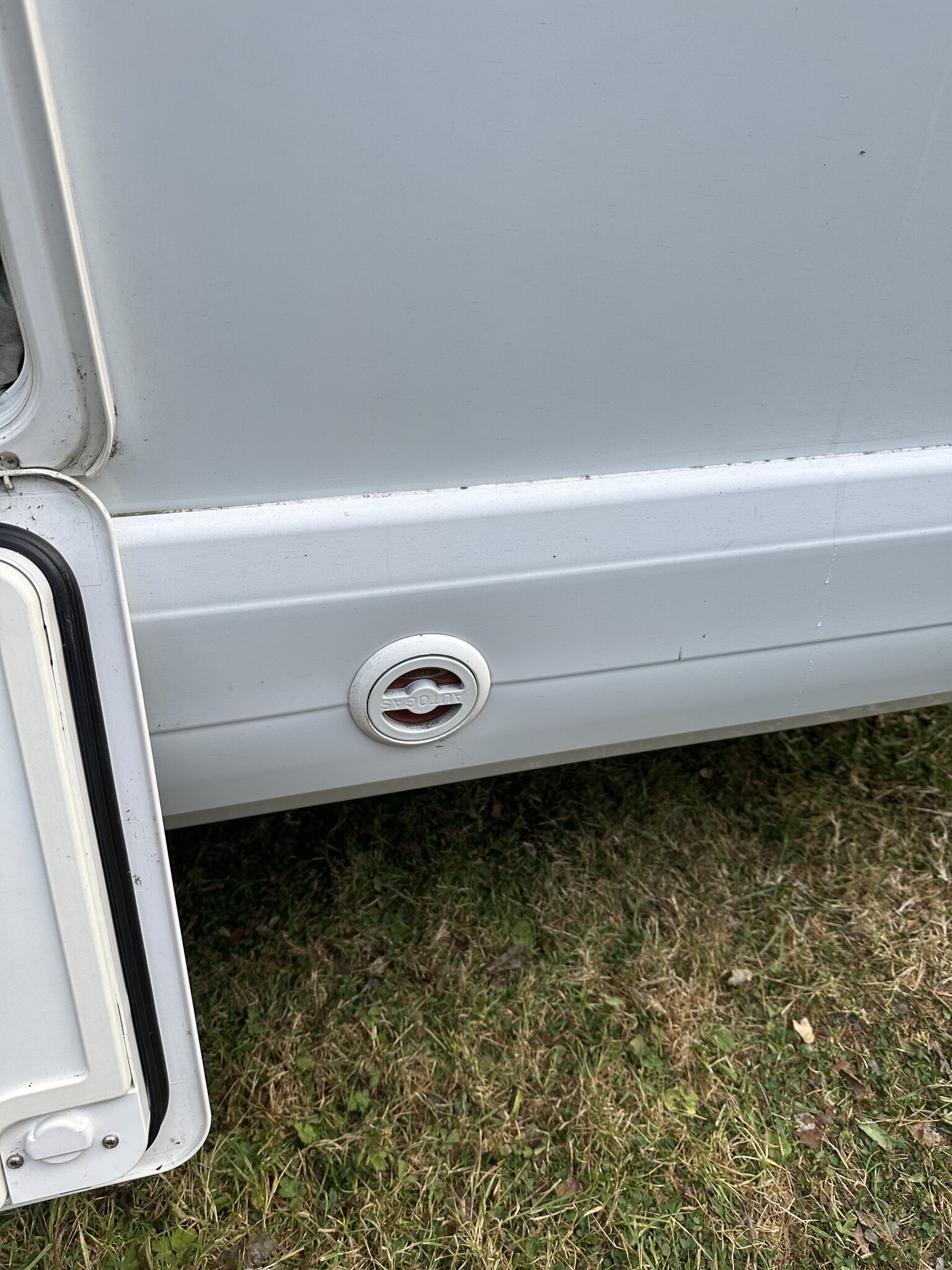

I seem to have a problem with filling the gas bottles. It was professionally done and there has been no problems. But recently I went to the garage to get them filled I noticed that one gas bottle had emptied only 4% gas left in one bottle other full everything worked ok. The other gas bottle we used until it was at 20%. I’ve just been to Morrisons garage and refilled with gas one is full the other bottle just filled to 20% ?? Both taps are fully open.
Any ideas what to do.

Thanks for your help so far. One gas bottle is 100% and one is 20% I know by the weight of the bottles. How do I manage to fill both bottles to full. Usually when I refill they both fill to 100% ??? Someone must know. I don’t have gages. I just go by weight or the Truma gage.

They look like gasit bottles I suggest you ask them. They have an 80% maximum fill to ensure you take gas vapour out rather than liquid gas maybe the float for the 80% limit device is stuck in one of the bottles.

If all you say is correct then the next most likely reason as has been said would be the cut off float is stuck. Other than this the next possibility would be a blockage in a filler pipe to that cylinder. This could be a kinked pipe or a break down of the inner liner.

We have had to bash our bottles sometimes with a wooden block on thecbottle shoulder. Just a sharp tap. I had forgotten about that. Yes the valves do stick sometimes. (y)

The 80% fill valve operates similarly to a ball valve in your w/c.cistern.
So if you suspect it is jammed it will be jammed in the up position l would remove the bottle and dump it down on its base a couple of times, this may work, and won’t do any harm, but if there is dirt in the valve as said I’m afraid it’s back to the manufacturer.
