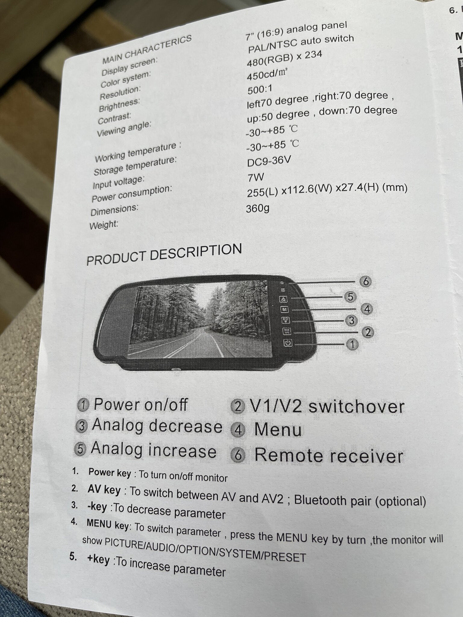

My 7" rearview mirror monitor was working perfectly until today. Driving along and it started switching between AV1 and AV2 (AV2 then shows blue and stating No Signal). it's always been on AV1. The instructions don't help with troubleshooting. I can get only the Picture menu on AV1. When I press Menu key as it states, to get to Volume, Option or System, that doesn't work. The menu key stays on Picture and when pressed again selects Bright/Contract/Colour.
I've switched it on/off but that didn't work. I've tried the remote but that doesn't work. The van came with the camera already installed.
I can't drive with it on as the flickering between AV1 (picture working perfectly) and AV2 (blue screen) quite distracting. I've added the instruction booklet here in case you know the system...
Any ideas what to do?
