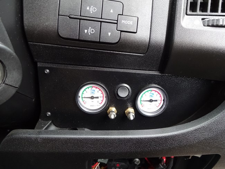

Like this setup I fitted

Like this setup I fitted View attachment 715716
My recently fitted setup is like this. I appreciate that the running pressure will vary depending on the load, but is the 1.8bar (ish) pressure yours is showing a ballpark figure to set it at until I've managed to get some miles in and get a feel for what it needs to be set at?
Perhaps a bit more, say 42psi ( 3.0 Bar). The bags are usually good for 5.5 bar. Pressure within also increases with temperature and leaning on pressure.
Our rear axle weight is around 1950kg loaded and I normally run at 34psi on the airbags. I’ve recently uprated the tyres from 215/70/15CP tyres to 225/70/15 Hankook which has further improved the ride, a lot quieter too.
