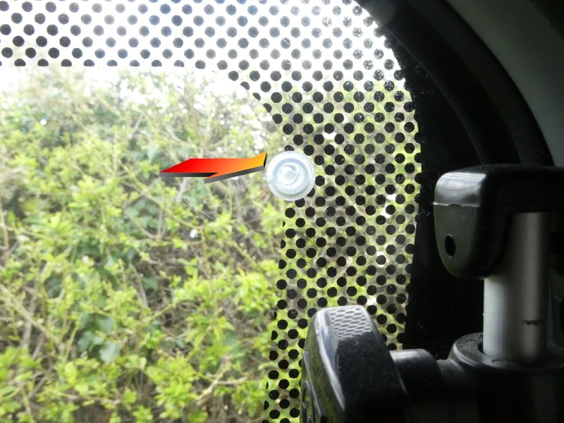

Normally the double glazed plastic windows have a plastic bung towards the top corners as arrowed, and if you pop these out and heat the window with a hair dryer the moisture will evaporate off and you can then put the bungs back in.
It looks like the areas I have circled maybe bungs in your window.
Acrylic is microporous which means moisture will penitate it, all vans get it nothing to worry about. As Paul says take the bungs out and either warm the window or just leave then out on a sunny day.
