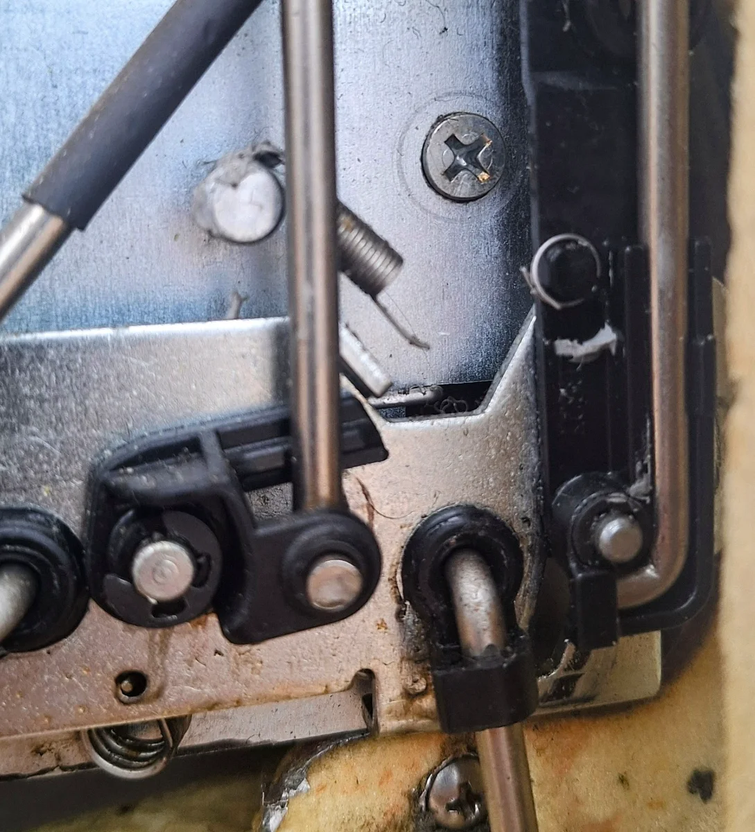

The Knaus habitation door lock has 4 springs.
3 are prone to breaking, and that's from experience!
The symptoms you mention are most likely one of 2 broken springs.
The simple one is a small coil spring on the top right which acts to pull the sliding mechanism back into place towards the right hand side.
See the photo showing part of the spring still coiled around the post.
It is an easy fix, either by rebending the broken end of the spring around the restraing post (which is what I did) or make a new spring from off-the-shelf coil spring from a major hardware store.
The next culprit is a coil spring at the top left.
Mine broke mid-point of the loop around the restraining post so I visited a major hardware store, bought a metre of appropriately thick coil spring (they only sold it in 1 metre lengths) and cut off about 30mm, then using the broken spring as a template, bent a new one which works perfectly.
The 3rd culprit is shown with a red circle around it.
Mine broke while touring Africa for 7 months and when I arrived home to make one, I found I'd lost the bits.
So, I'm trying to find where I can buy one since Knaus have not answered my 2 email requests, and my dealer days the only solution is a new lock at €295 😩
Hope this helps 🙏

Hi, I tried to send a reply but looks like only the photos went through and not the text.
3 springs are prone to break.
The small one at the top right is an easy fix, I just bent a new loop at the end and refastened it around the restraining post.
The top left spring broke in the middle so I made another from coil spring purchased at a major hardware supplier.
The lower centre spring broke (see highlighted in the red circle) but I lost the bits somewhere along the way in my 7 month travels through Africa.
So I don't have the bits to make a copy.
I've sent 2 emails to Knaus without reply.
My local dealer says the only solution is a new door lock at €295 😩
If anyone knows where to buy one of these I'd much appreciate it
