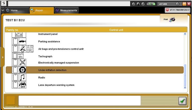

If you come across a Peugeot dealer who doesn't know how to configure the TPMS using their own Diagbox kit (to be fair it is quite well hidden) then you could always give them a lesson - but negotiate a discount first!
Select vehicle type then:
'Repair > Test by ECU > Under-inflation detection > Repair > Spare part > Reading of the reference pressure of the tyres'
and 'Setting of the reference pressure of the tyres'.
