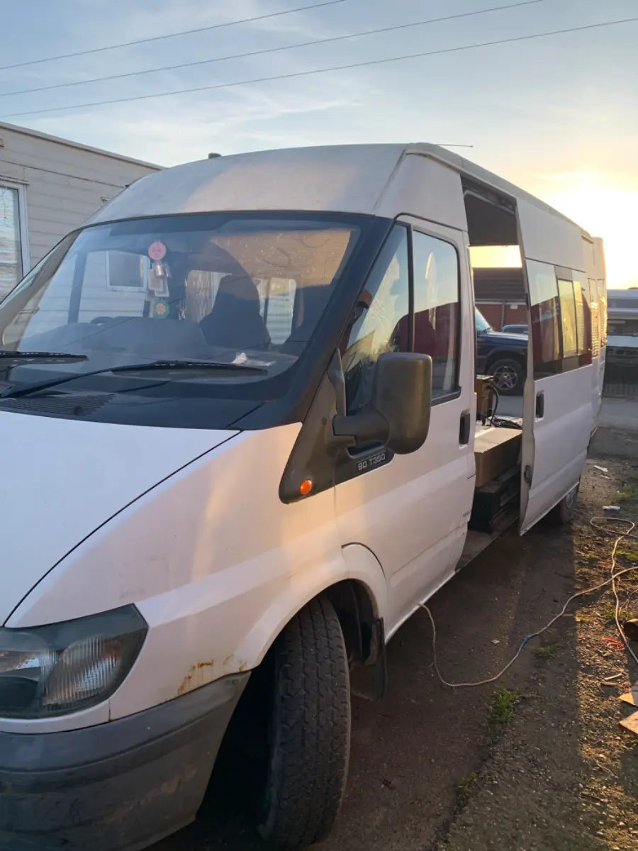

What van are you converting any outside pictures please looking forward to following this 👍

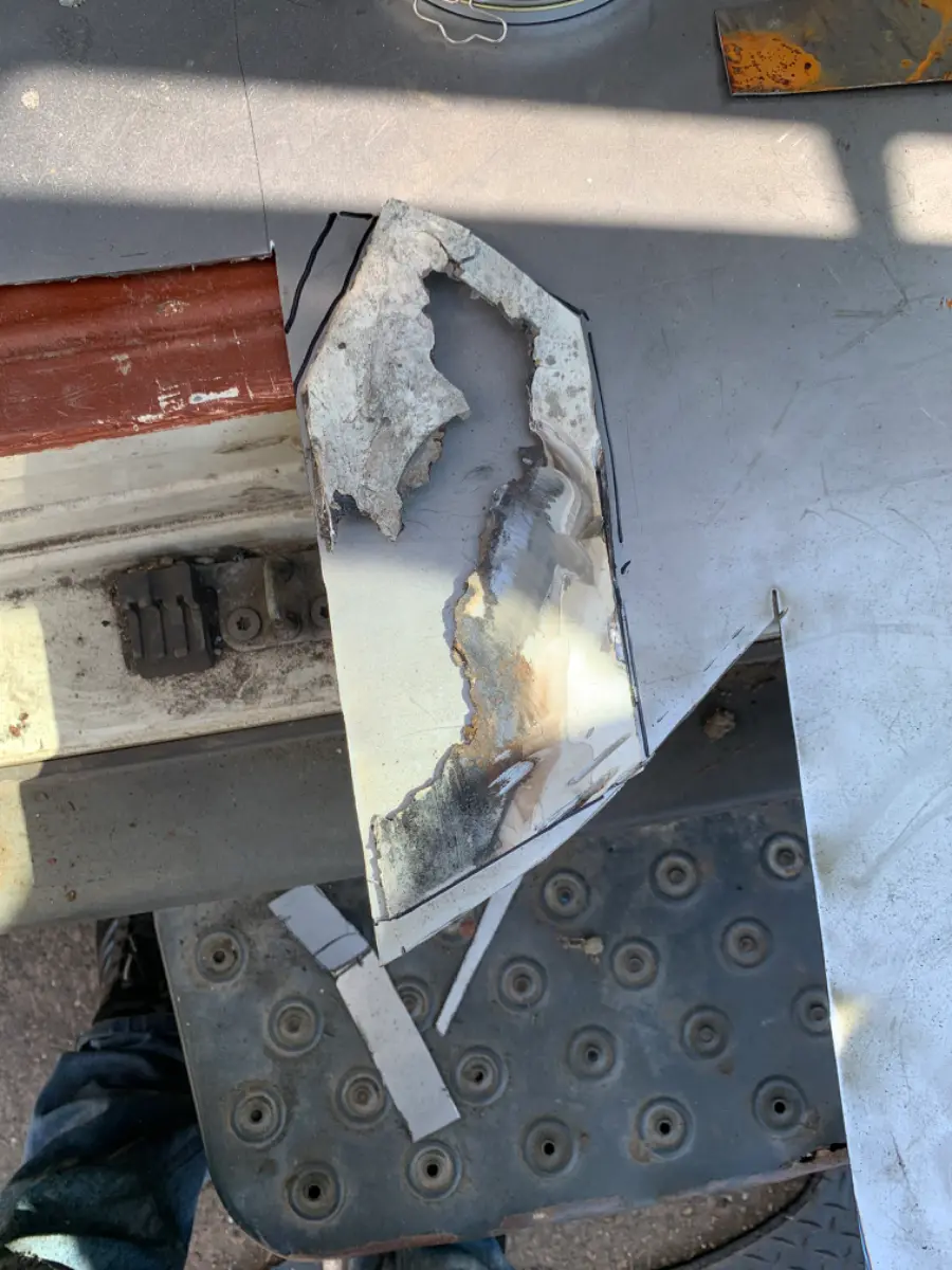

Made the iner part of the wing new whell arch on the way I did start to make a repair panel but it would have been plenty strong enough
It just wouldn’t look right.

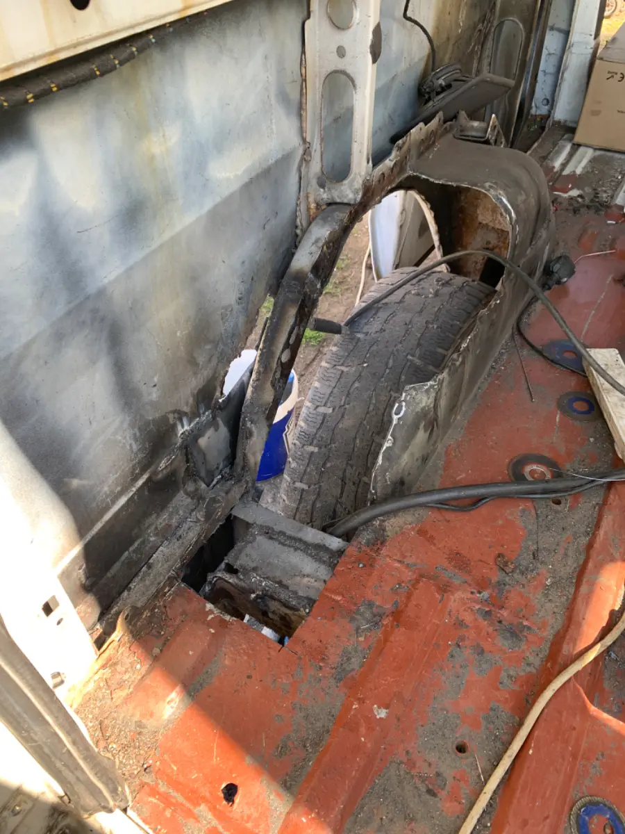

So ordered a new wheel arch coming Monday
Any whare I see rust it getting cut out to good steel the way I am going ther won’t be much left
WB
Of all the vehicles I have ever had the misfortune to work on transit have the thinest crape stell of them all
Chases. Fine body Panils so thin to weld plug welding is ok .
But I prefer to do a full but weld but the grinder sorted out most of my mistakes
Flushed it back.
Treated where I can with rust treatment finish of with under seal
Both sides bit of filler over welded arias
Job done
