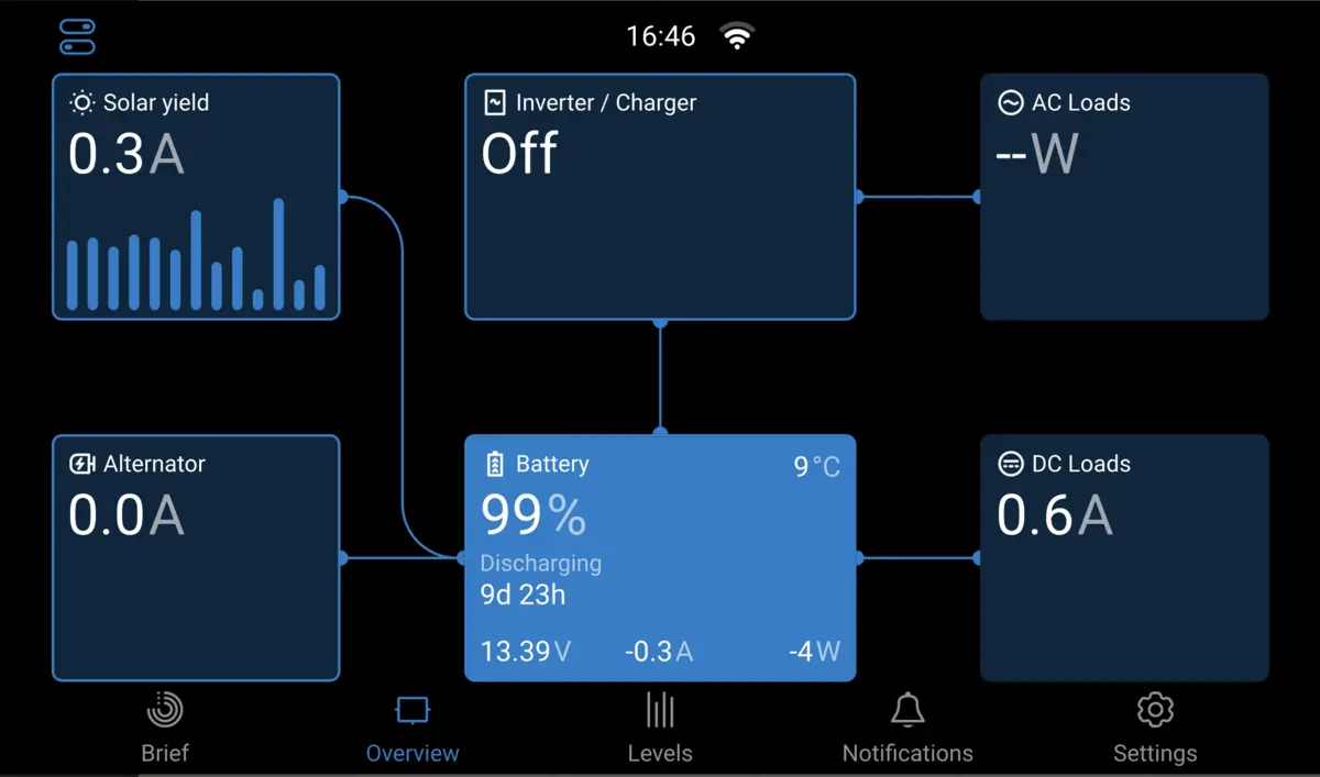

The xs shows on mine, as alternator, wonder if it's software version?
Ah that's the vrm gui2 one though...
Excellent, thanks. 👍
Tried it, doesn't show on either of the home screens but if I go to Setting then Device Manager it's there and I can click on it and see all the info.
I didn't think you were running a Raspberry.
No I'm not, but surprised the console didn't show the XS, then I realised that I am on Gui V2 console and meant to delete or clarify, then the wife got back from the shop and moaned for me to get a move on - then I regretted reading the post......

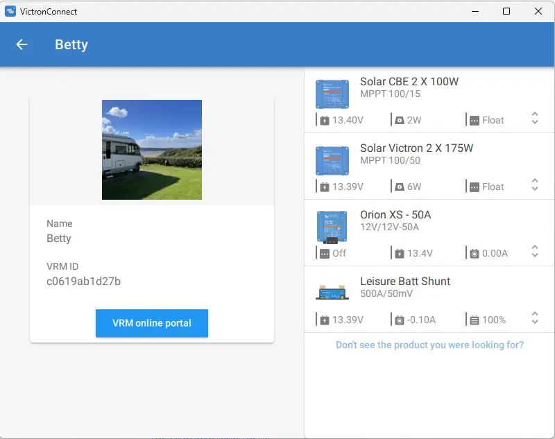

I can see them all fine in the Victron Connect App (via Bluetooth) but the Orion XS refuses to appear in the VRM Console (via ve.direct cables). The cables were purchased from Duppa.net with the USB hub and all seem ok but I had to butcher one to connect to the IP22 internal PCB.

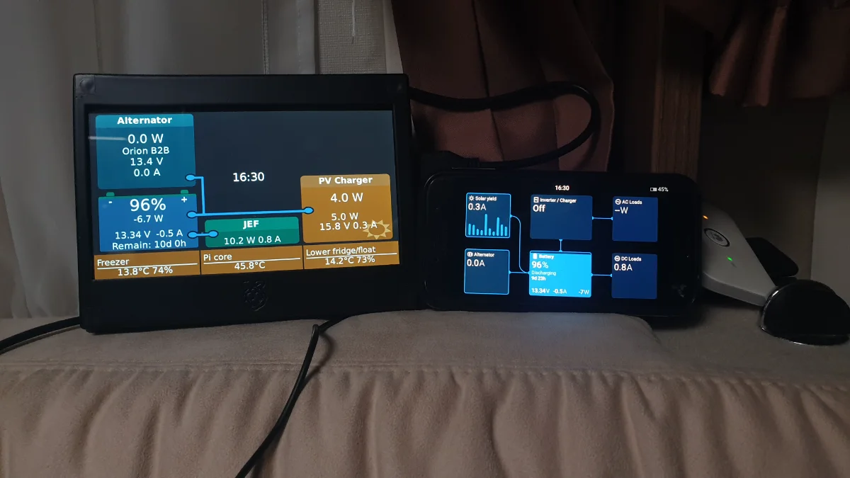

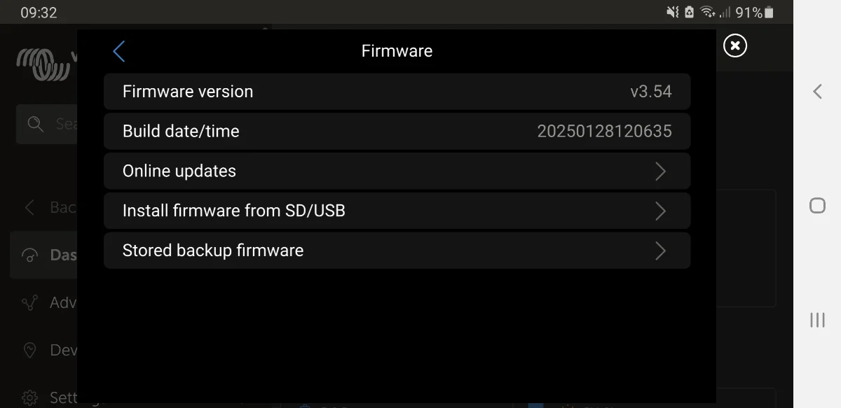

I then updated the 'firmware' on the Pi to 3.54 using the VRM portal (that worked really well) and also turned an old Samsung phone into a dedicated display (thanks again AdrianChen ).
So a succesfull day in the end - with the exception of the XS. I've seen a bit of internet chatter about issues with v1.07 of the XS firmware but mine is v1.06 and Victron now reports this as the latest. I might try and swap the Rx/Tx in the connector as I needed to do this for the IP22.
