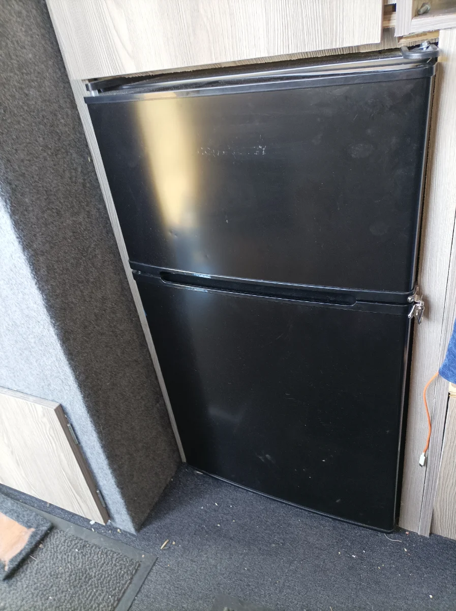

it looks like we are going to have to replace our fridge in our 2010 arto it's a RMT 7855 has anyone replaced this unit and what did you replace it with cheers scotty
Not specific to any particular van but a much lower cost and greater choice alternative is to buy an ordinary domestic Fridge or Fridge/Freezer and run it through either existing inverter or a small dedicated inverter...will use circa 40/50ah per 24hrs( on 12v) Circa £300 Inc inverter.

We swapped from a RMDT8505 3 way to a Thetford t2160 same size straight swap, just removed the gas feed and used the 240v feed for the microwave with slight alterations to 240v supply.
When I first fitted a domestic fridge we had 200ah lead acid and also ran a compressor cool box at - 18 to use as a freezer in the summer.We hardly ever use hook up,the fridge works hardest and uses most power when the ambient temperatures are high...IE when it's sunny and solar is producing most energy.We are currently in Spain and the fridge/freezer is running about 20 mins per hour at the warmest part of the day (using1 .33ah per hour) I haven't checked night consumption ..we currently use 30 to 40ah sun set to sunrise...but are running the off grid property off the van ( lights,mains water pump etc) as well as the van fridge freezer
Another option is keep your existing fridge, remove all the absorption plant and controls and fit a compressor kit. I did it and it's fantastic! Only runs at about 2 to 3 amps. And much cheaper that buying a new fridge. DIY kit no commissioning needed.

Solar/lithium doesn't have to be expensive,I have 440w fixed panels 640ah lipo,50a B2B with built in mppt ...cost circa £1 k drop that to 320lipo £750 total...ad a fridge freezer and dedicated inverter Still around £1k

I think it was an RMS8400 by Dometic
The stat that comes with the kit is a basic mechanical one so I fitted an electronic controller too 👌

Our current f/f bought from eBay circa £120,If you have the patience to look at eBay,Currys,Argos,AO etc sizes can be found but often not easily
