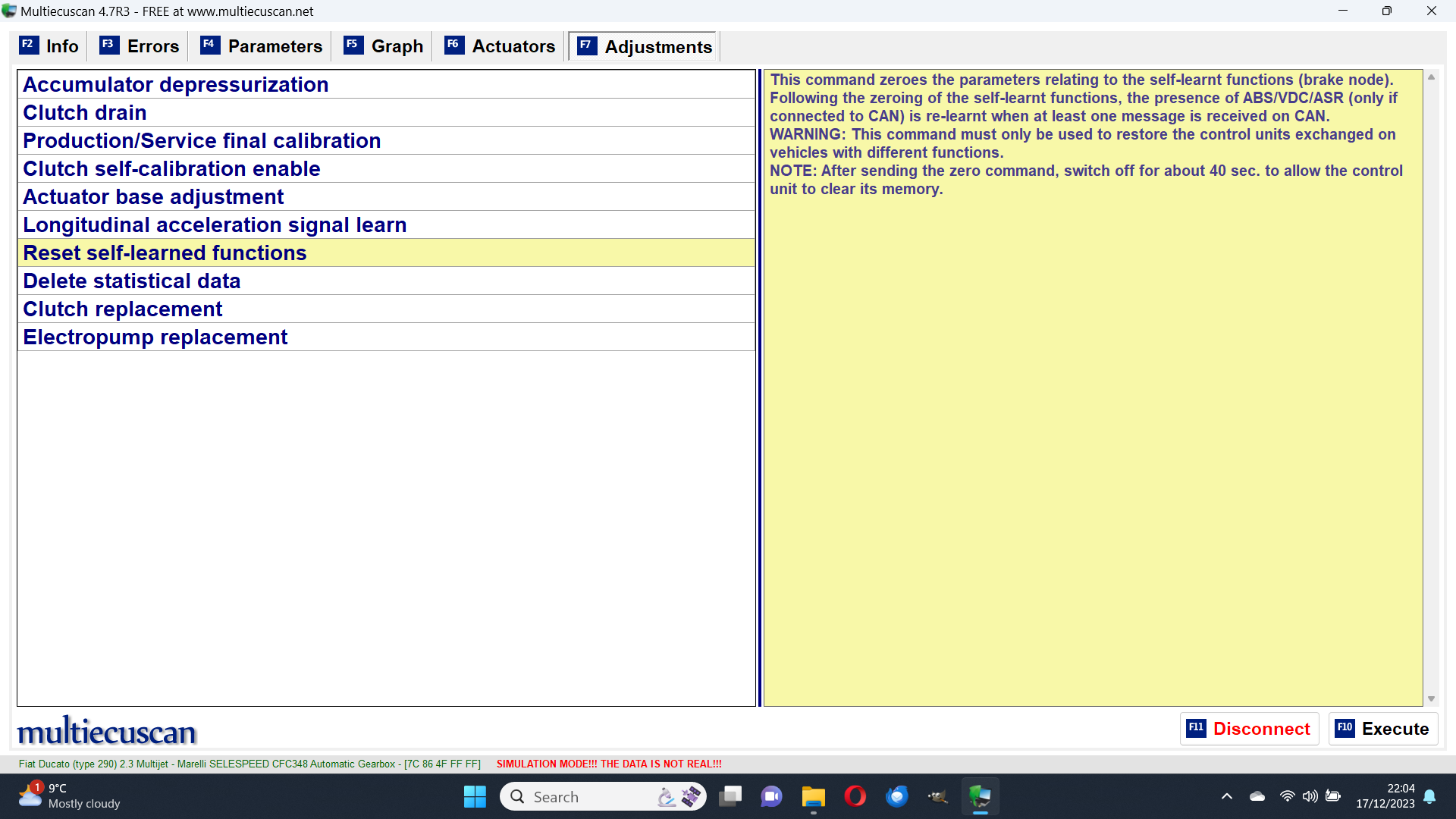

here are examples of multiecuscan v4.7 (does everything needed 2018) latest v5.1 has additional canbus stuff 3 gearboxes etc this is the simulation mode perfect for playing.
View attachment 845440View attachment 845441
