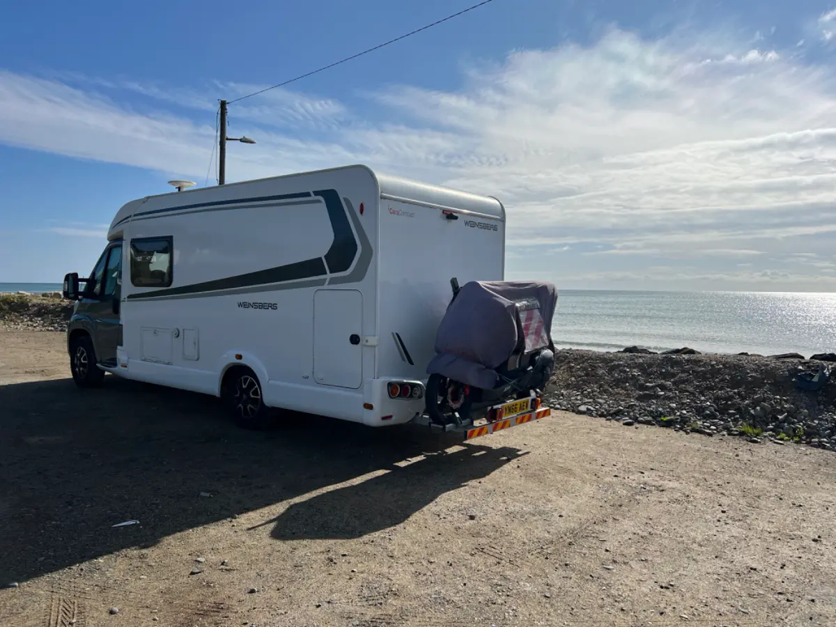

This is ours. The good thing with a rack like this is its dead easy to load. A full lengthy ramp and you just rev it up. One seat clamp ratchet and one through the front wheel. Thats it.

We carry a Honda PCX125 on a rack which bolts onto tow bar rack which is on an alko chasis

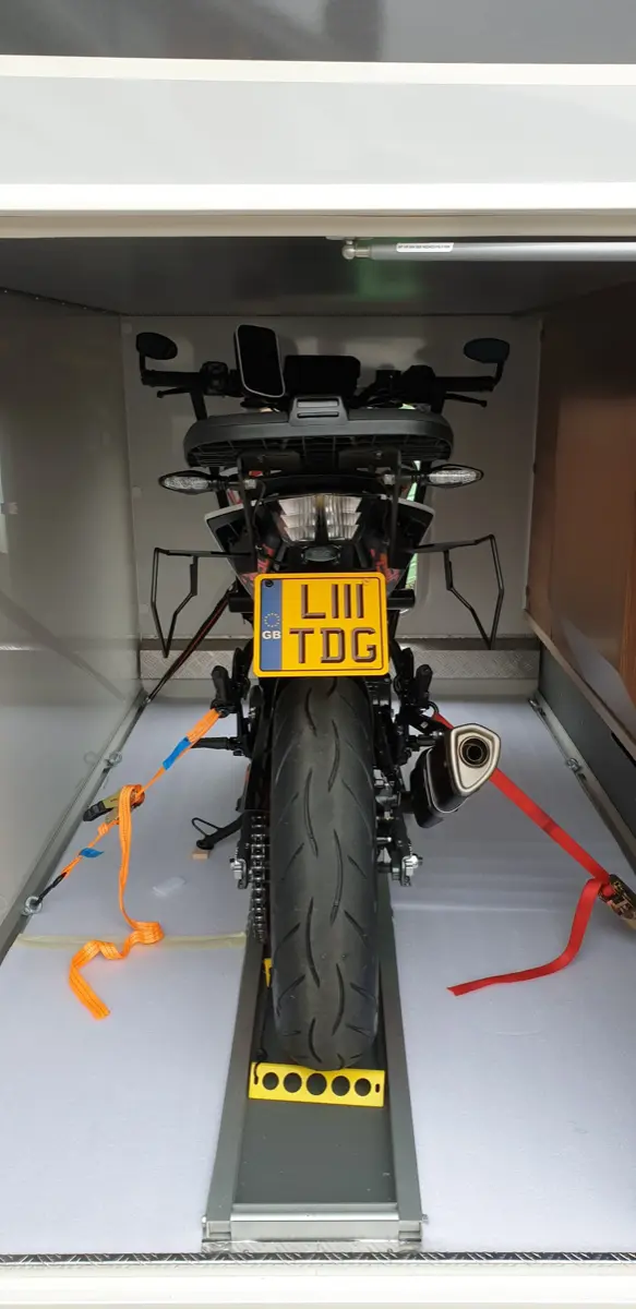

The KTM 390 Duke is a cracking little tender @ around 170KG kerb weight, only negatives for us were the vibes from the single pot at speed and the pillion seat tilting forward a little. We had Shad luggage which held two helmets in the top box and bike jackets in the panniers. On the return trip the panniers and top box carried food, wine & beer.
The Honda scooter is a similar weight, comes with storage under the seat but actually takes up more room in the garage as it has more bodywork low down. The same top box fits the scoot so storage options are roughly the same. We also needed a longer ramp to get the scooter in and out or it grounded out on the scooter floor.
The loading is a five min solo job with a sliding dolly to assist.
