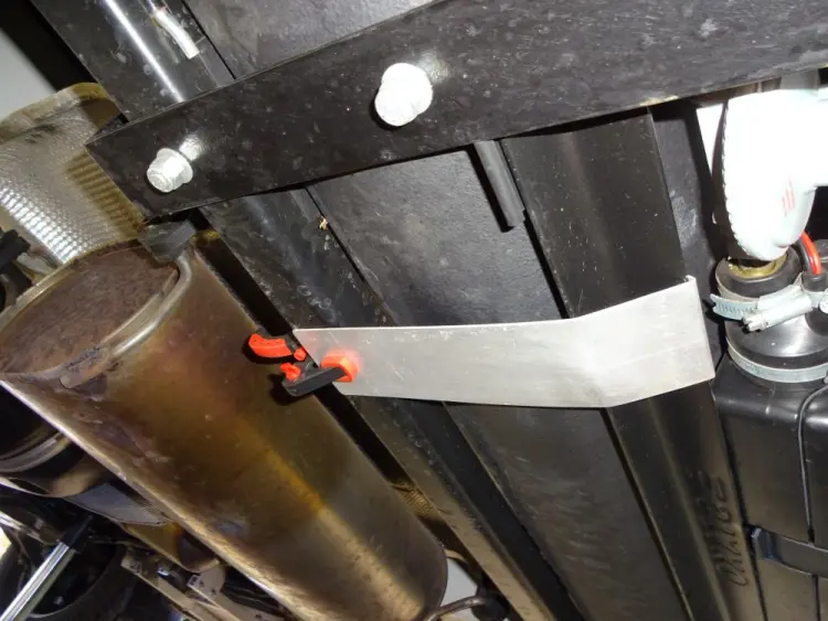

I might get one for our underslung gas tank, is it an easy fit?
The Mopeka sensor has a magnetic base which will hold it to the tank. The phone app for the sensor has an alignment menu to get the optimum position to mount the sensor.
I made a thin aluminium strap to hold the sensor in place just in case, and to give it some protection from road muck.
The photo is of the trial fitting of the strap, which is now painted black and held in place with a self tapping screw.

Hi Everyone. Can someone help me. I emailed LPG shop to ask which sensor to order for an underslung tank and they replied none of the Mopeka are suitable :confused: yet it seems on here many have them. Can someone give me a model number perhaps. Thanks in advance.
I'm using the round grey Mopeka Pro LPG on my underslung tank and it has been working perfectly and accurately since fitting it a couple of years ago.
You can see earlier in this thread that I have mine mounted on our underslung.
Hi Paul
Thanks for that. i have the mopeka on my fresh water and it’s great but thats a flat bottom tank. How did you get pst the curve of the cylinder as I can’t see in the photo. Mind you yours looks a lot less cylindrical than mine if that makes sense.

We are in New Zealand at present, but when we get home in a few days I'll take some photos of my setup and how I have mounted mine.
I have one on a toridial underslug tank, it works fine.
