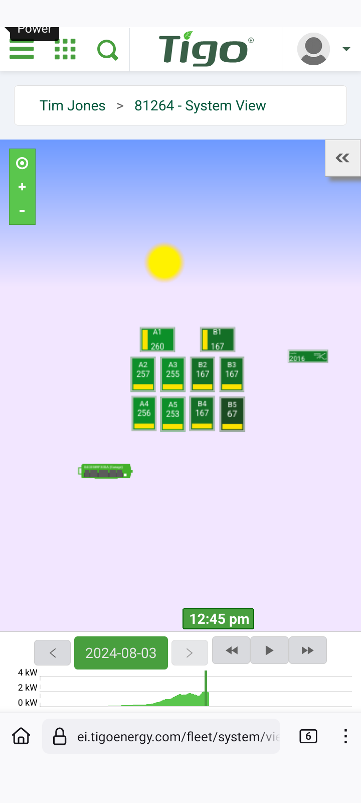

Not sure if this is applicable to motorhome panels but you can use TIGO optimisers on each panel which will then allow you monitor the output of each panel. That is what we have on our house system. They are also supposed to optimise output but the jury is out on that one!

Example of what data is available.
