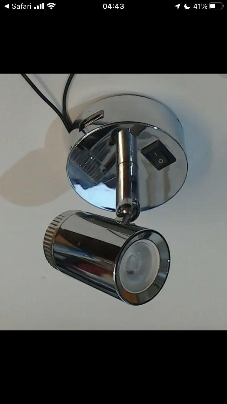

We replace our 12V spotlights with these which have a USB port for charging things. Available on eBay or Amazon for around £20 per pair.
