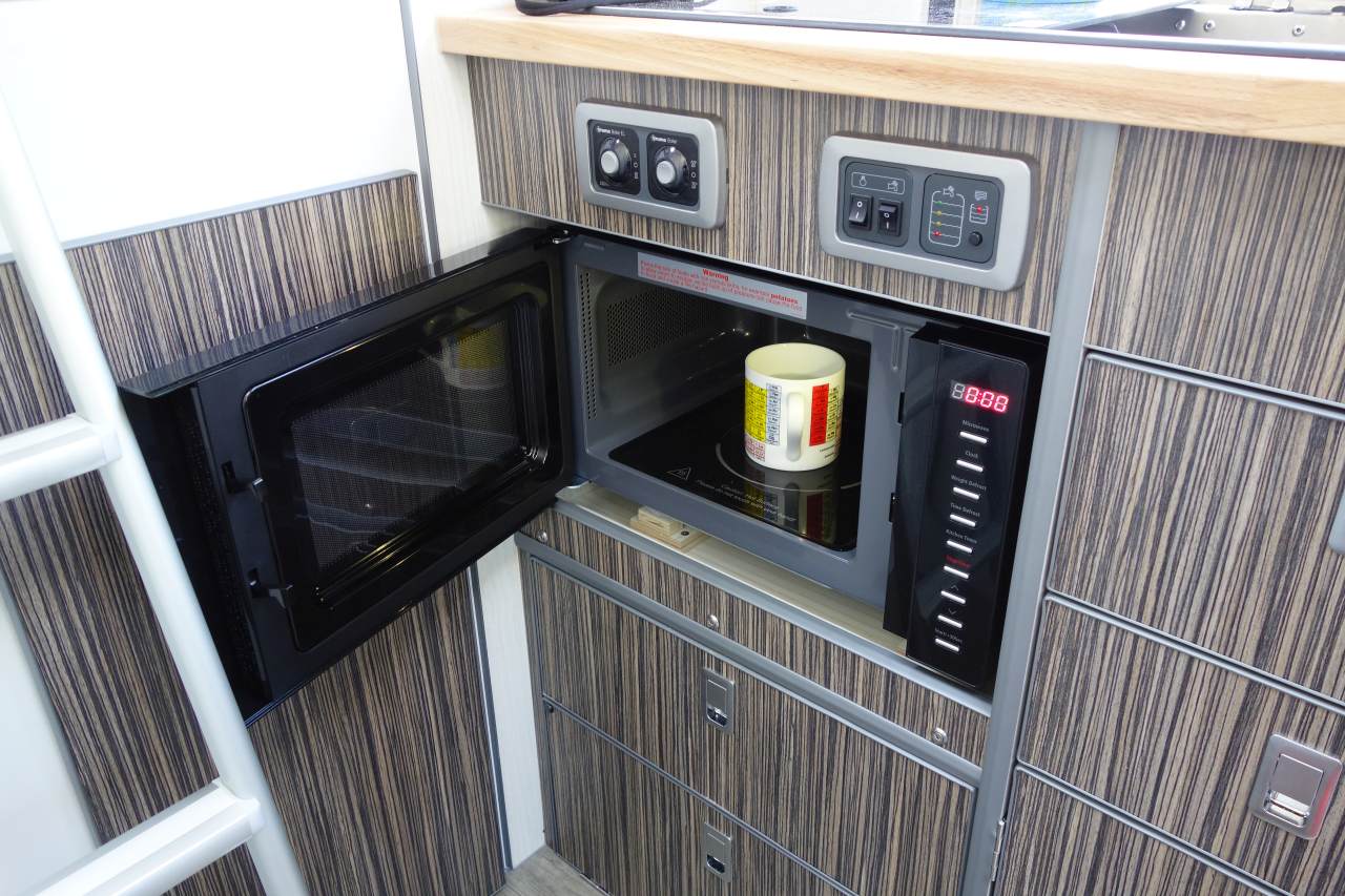

I think this is the kind of specification you need. I have fitted this model in my MH and it runs happily on full power from Spanish campsites with 6A supply.
Broken Link Removed
It has a 20L capacity which is more than enough and a rotating plate.
