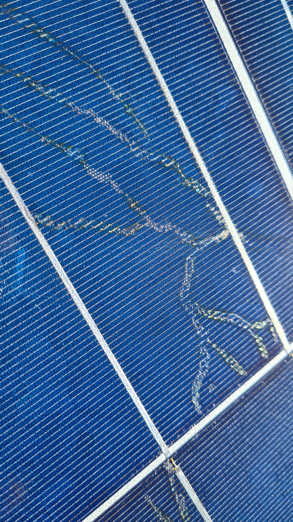

Went up the ladder to clean the Sahara desert off my 6 years old solar panels today and discovered these odd marks on one of the panels. They extend to 3 or 4 of the squares. Are they a problem or is it just a natural phenomenon?
Do I need a new panel?
Are the marks under the glass?
If so it looks like you have condensation problems, this will probably affect the output from the panels, however if you can check with an amp meter/volt meter, and its within your tolerance/needs for batteries to get back up to strength, then just put up with them for a while longer. It really is whether they are doing the job for you that counts, if you have a back up B2B charger when on a run, then even better.

It is under the glass. It is a 150W panel and I also have a 100W one and they are wired together. It is very difficult to know exactly what power you should be getting at this time of year from the 250W of solar. As long as I am not using the motorhome they will be OK because I am plugged into the mains. But we will be using it in Europe in the very near future and spending most of the time off grid. Experience tells me that we can easily cope with the two panels. But I doubt we would if the larger panel is duff.

Not seen it before but looks a bit of corrosion caused by damp getting in, I think you will just have to monitor it & see if it gets any worse effect on performance is a difficult to measure as the brightness of the sun is constantly varying.
On a nice bright day you could discharge your batteries a bit then you could unplug and measure the output from each. Best if two of you do it as one can look at your BMV while the other does the swapping to get the best result. Although two different size panels a bit of simple maths will sort that.
That’s a classic example of micro cracks. They open in hot weather and brown the contacts. Yes the panel will still work, but at reduced.capacity, due to the resistance induced by the brown points. Snail trail is a bit more subtle, but not far of it. It is possible that was less obvious a year before. I have a couple like that, not worried yet, until the burning of lattice gets to big to transfer any current.

It looks like you have a disconnection in the internal wireing of the panel. Visually it is not enough to conclude but have to test the system with a meggar or volt meter. Speak to the people you bought the panels from to give you an idea or an estimate if that is the case. Regards
As Eddie stated it's called a Snail Trail.
The industry has pretty much moved on from "Don't know if it degrades performance" to "It degrades performance but by how much we don't know". General thinking is that moderate damage drops 20-30% and of course eventually a panel produces nothing if severe damage and in the right places. Some panels even have a hole "burnt through" if it's really bad.
The challenge is how to define minor, moderate and severe damage. No real definition. I guess if you've recorded output for given sunlight conditions you would be able to determine performance degradation ... but who does that?
