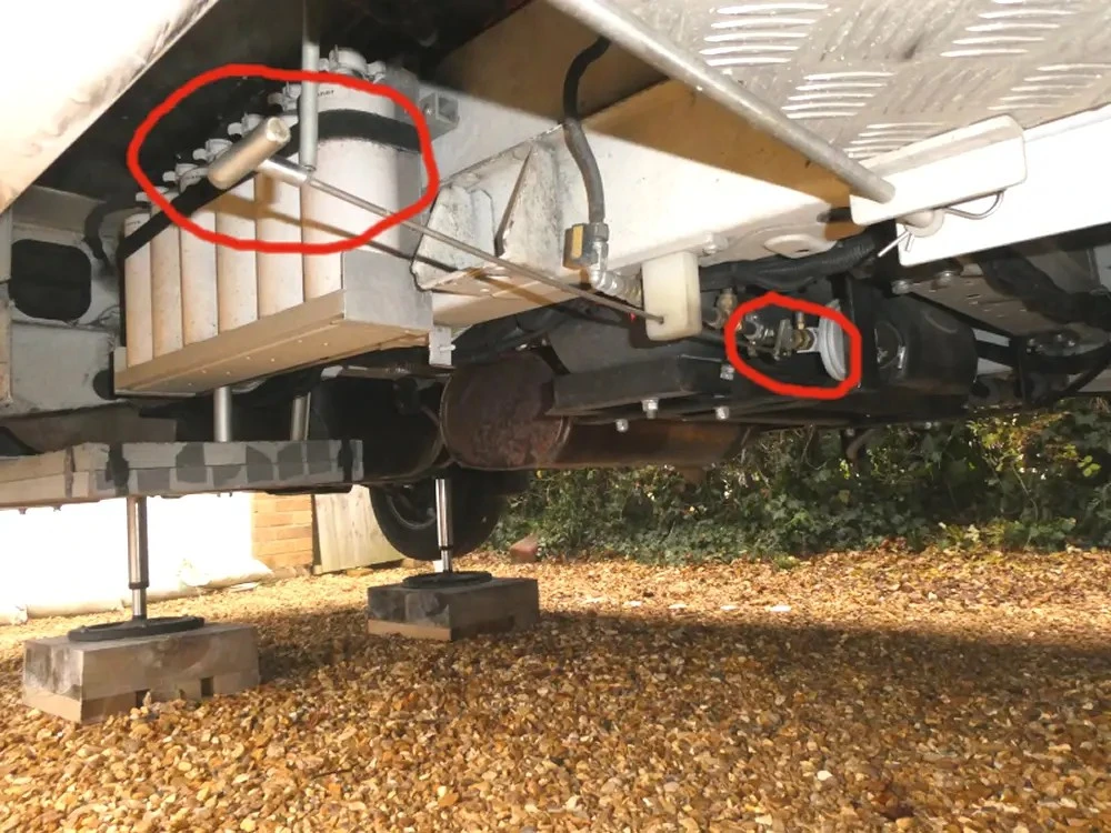

Here are 3 photos of the tank on my previous van- date stamped 2006. The brackets had rusted away and the tank was just wedged in place. I know it's more than 10 yrs old but it shows just how bad they can get. Probably be worse if you live near the sea.

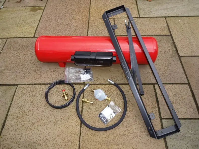

When my underslung lpg tank arrived, the first thing I did was to lightly scuff up the red coating and then give the tank several spray coats of a rubberised anti-stone chip coating.
I made mounting brackets out of 6mm steel bar that the tank is fixed too and these brackets have sixteen 8mm bolt bolting them to the vans chassis cross members. If for any reason the the tank straps fail (which are also coated in anti-stone chip), then the tank can not fall from it’s mounting frame.
Mine was a GasIt tank, but first thing on the installation instructions was to give it a protective coat of paint
So I did
I left the paint to dry for a couple of days but it just didn't dry so a lot of it came off when mounting it.
So I did
Next time I'm going to use something else so I'm interested to know what your rubberised coating was Two on Tour
I ended up lying on my back under the van touching up the paint - which wasn't the most comfortable of experiences. Five years later when I came to remove the tank from the old van I can say that the paint was dry!
However, I had no idea that these tanks had a limited lifespan. That one went on in August 2019 so the big question now is whether I sell it off to someone who is happy to have a cheap tank for 4 years and put a new one on now for the new fit or whether I get 4 more years from it and have to go grubbing around under the van again.
It was a hateful job to fit on my own last time so I'm starting to think it might not be the worst idea just to put a new one on now and be done with it. Decisions, decisions.
The added Waxoyl was the problem with your Hammerite coating as the Waxoyl is designed not to set. I used Comma Underbody Seal on mine.
