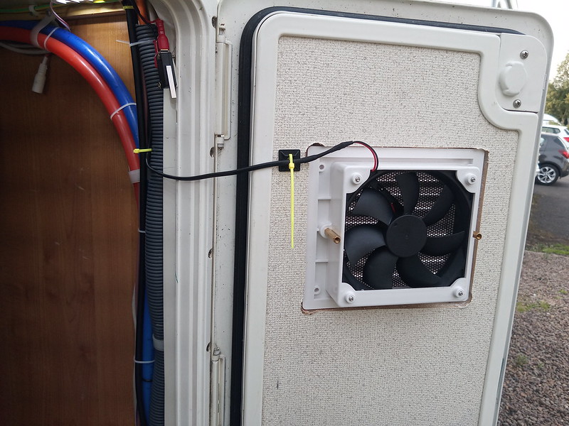

I have my Multiplus, plus a bunch of other kit, fitted in one of my external lockers
Victron Fanboy by David, on Flickr
Use a little temp controller like this for the fan activation (these are really good, very cheap and I have found them very reliable as well (used them in a few setups).
Temp Controller by David, on Flickr
Venting wise, there are gaps at the rear where air can be be pulled in from the interior living area (specifically the kitchen) and I fitted an vent kit to the door to extract.
The inside view
IMG_20210828_180322_2 by David, on Flickr
I think it looks fine on the outside too - or it would it I hadn't had manage to make the cut straight :( only very slightly out but bugs me!
Without cover fitted
IMG_20210828_172805_7
by David, on Flickr
With cover on
IMG_20210829_102123_7 by David, on Flickr
This is a proper Motorhome/Caravan vent kit so no problems with water ingress. (worth paying a bit extra to get a properly designed unit IMO).
