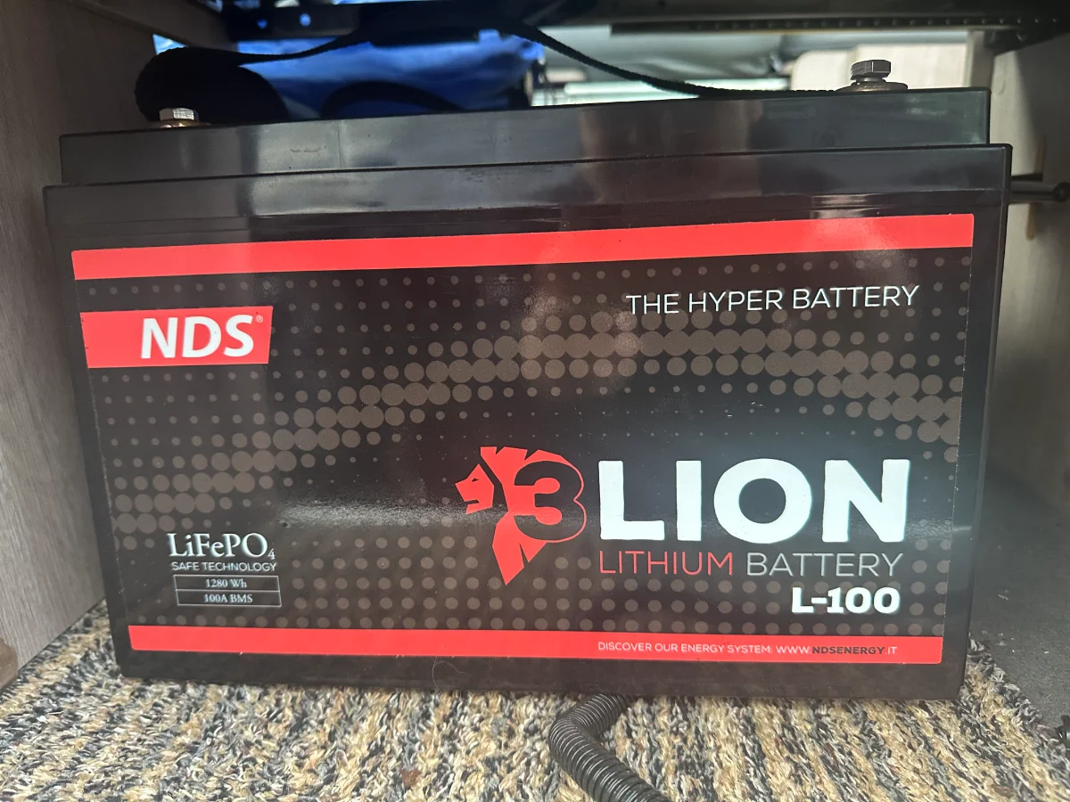

I will shortly be offering my surplus LiFePo4 100Ah batteries for sale.
Before doing so is there anything I can test that will give an indication to a buyer of their state of health?
I am getting 13.1V from each, does that mean they are healthy? I have no idea of their state or charge but I can connect them up to a lithium charger when it arrives this week.
BTW I have no reason to suggest they are not its just that I dont want to sell them if they arent good.
Thanks

An honourable thing to try and do before selling. On my Roamer LiFePO4 battery 13.1V would be about 60% charge. What make, how old and how heavily used?
Year 2021. Cant be sure if the usage because I am not the first owner. I have charged it probably twice in my 7 month ownership.
NDS Lion have a good reputation and are not cheap.
