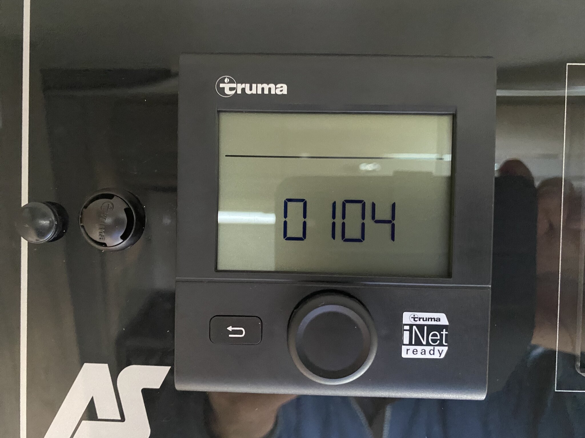

Okay. Cannot think of anything switched on. Just visited van in storage. Panel flashing and error code.
Went for 20 mile drive.

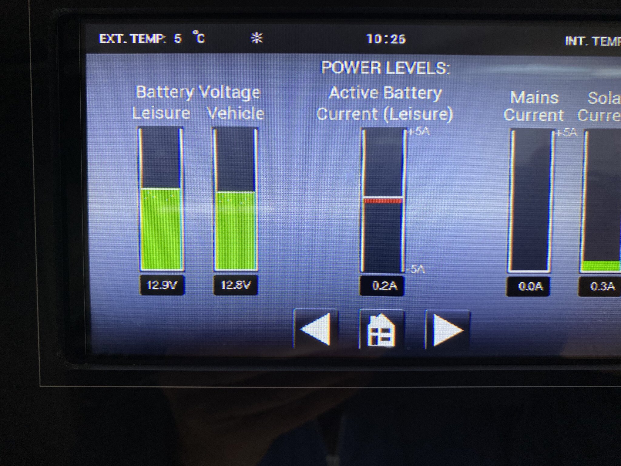

Error now replaced with incorrect time suggesting loss of battery. Batteries now charged. Little current being drawn. In fact less than solar putting in.
