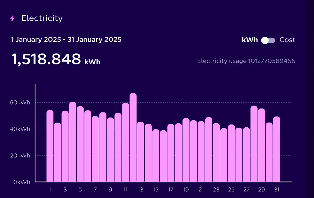

Here is our bill for January this year when all 4 of us were in the house and 2 motorhomes were charging on the drive (til I saw how much electric we were using). Other months are much more realistic and there is an argument for 30 kw but it is a grand for every extra 5kw so starting with 20 or 25

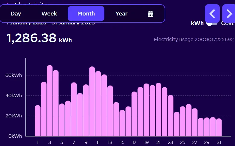

Im glad its not just me....

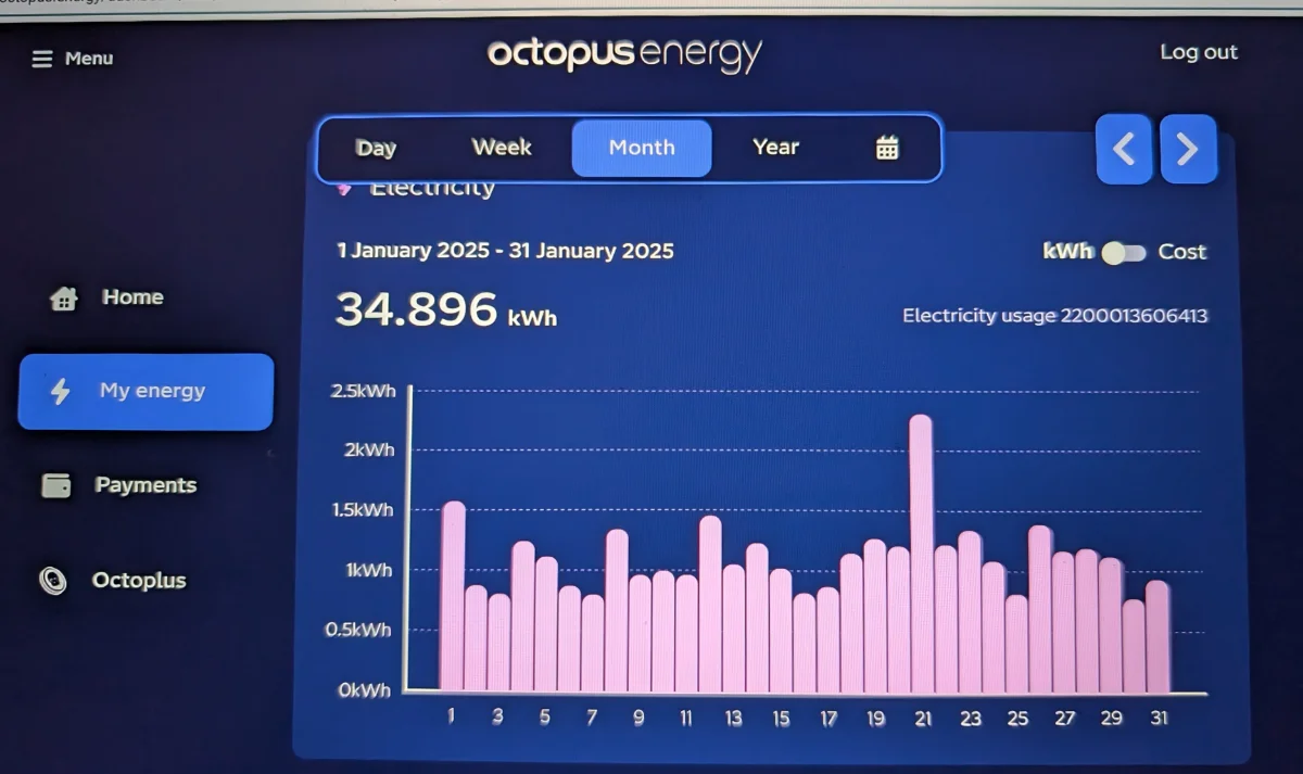

Blimey 1286 kWh - that's quite a lot. I know we use oil for heating, but our electricity (including all cooking) from the grid in January was less than 35 kWh. We've got some solar and 13 kw of battery storage.

Blimey 1286 kWh - that's quite a lot. I know we use oil for central heating, but our electricity from the grid (including all cooking) in January was less than 35 kWh. We've got some solar and 13 kw of battery storage.
When we arent even here !

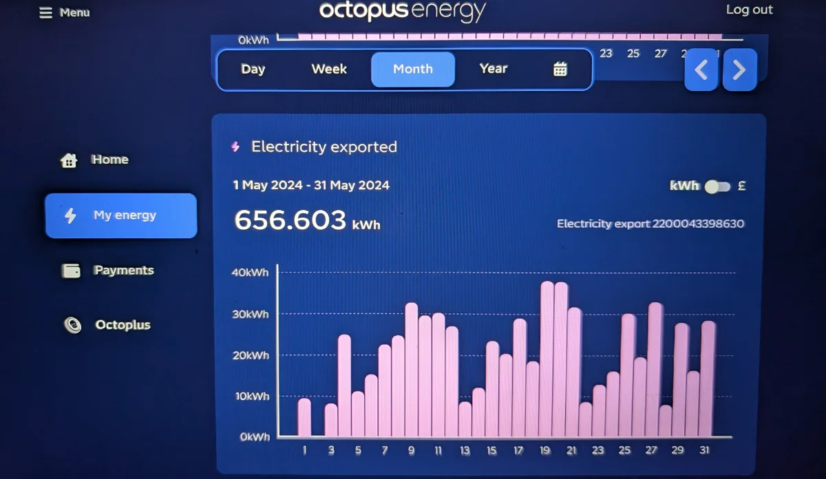

Should have said, same month 656 kWh exported to the grid, worth a credit of £104.93. :Smile:
We only get just over a grand for the whole year. We put the same system on the daughters house 200 yards away at the same time which has a lovely south facing pitch and she gets £2,5k pa
Bloomin Eck. We're all electric in the house and use about 300kwh/month winter and 80kwh/month in summer. Add about £5 of LPG and diesel in Moho.
